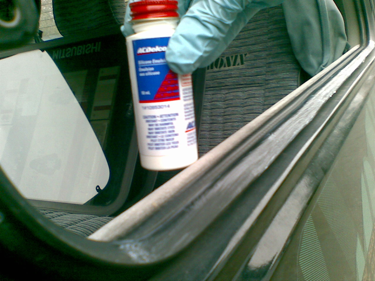

Once the windows are removed, use some Silicone emulsion (Lordco : AC Delco Silicone Emulsion (P/N: 10953014) that will revive the rubber compound in the seals. It's like oil/vaseline and goes on with a little applicator. It dries in 5-15mins and a few coats will do it.

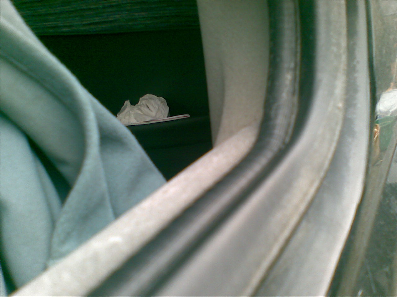

Windows out
Windows out

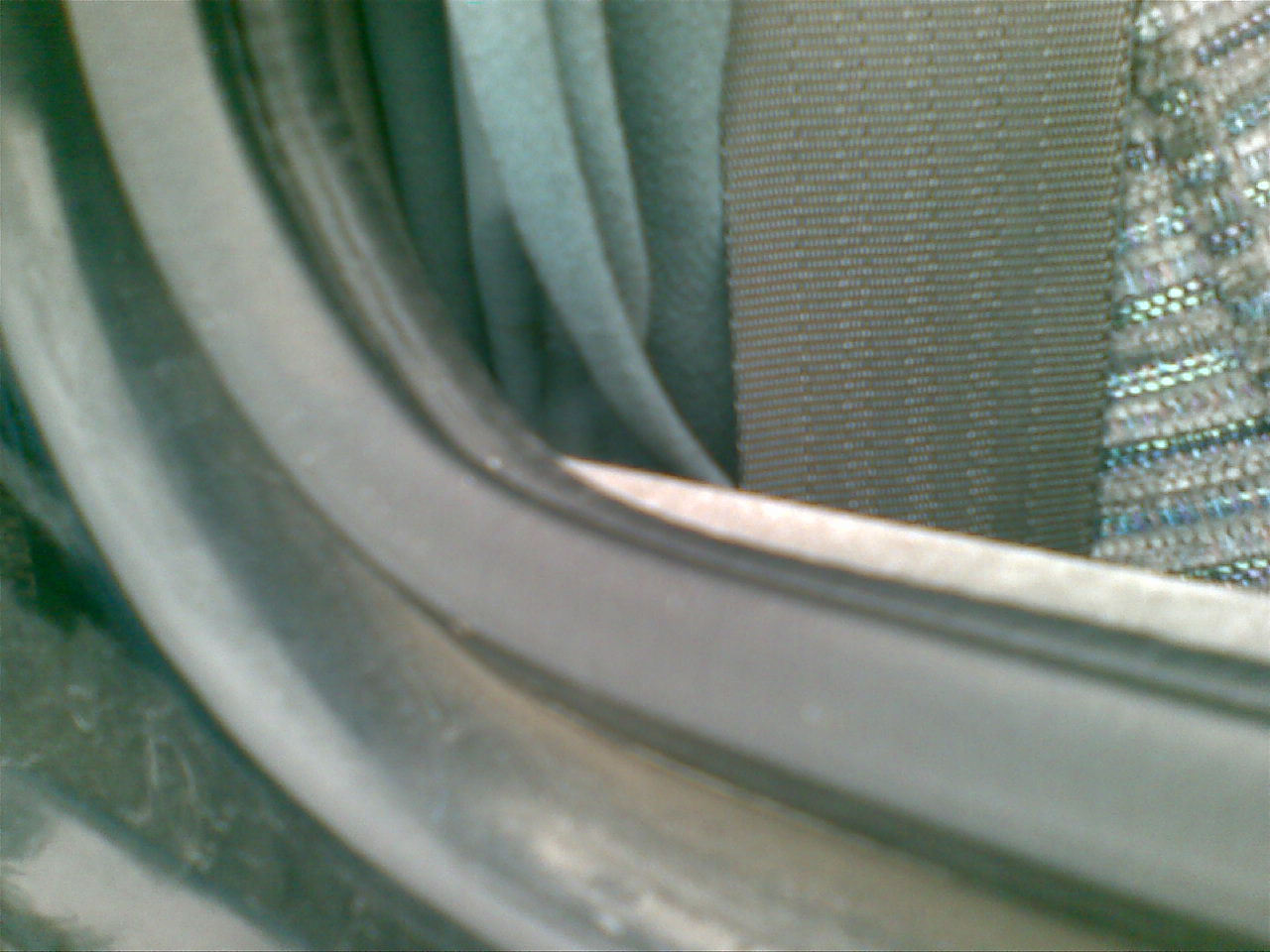

Dirty
Dirty
Clean
Clean
Applying Silicone
Applying Silicone

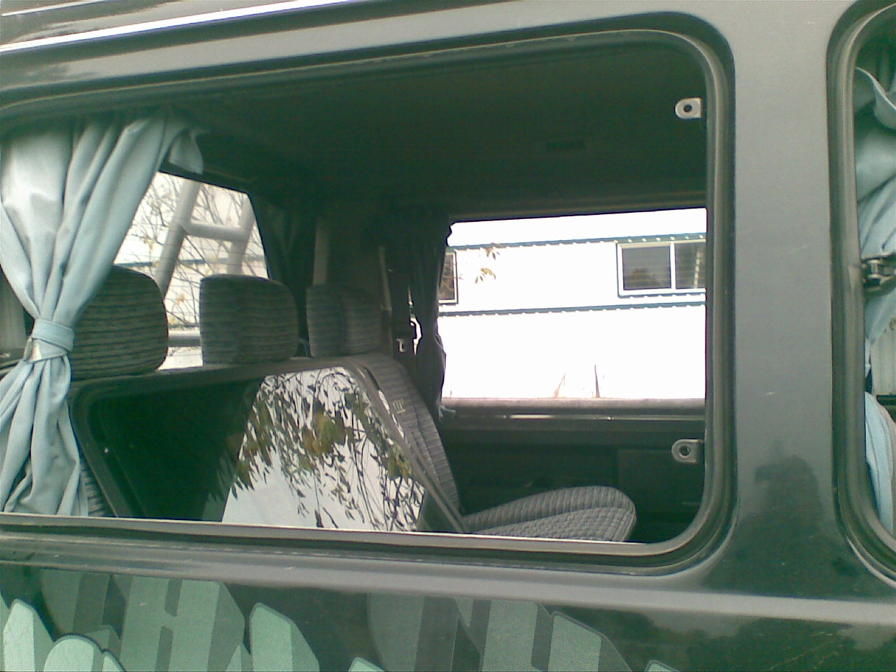

Pics uploaded.
Takes two people, 9 bolts and 5 mins to take all three windows out. Easy job.

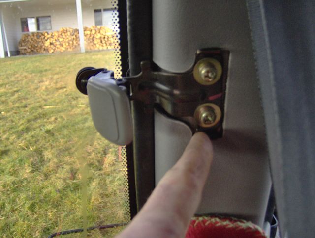

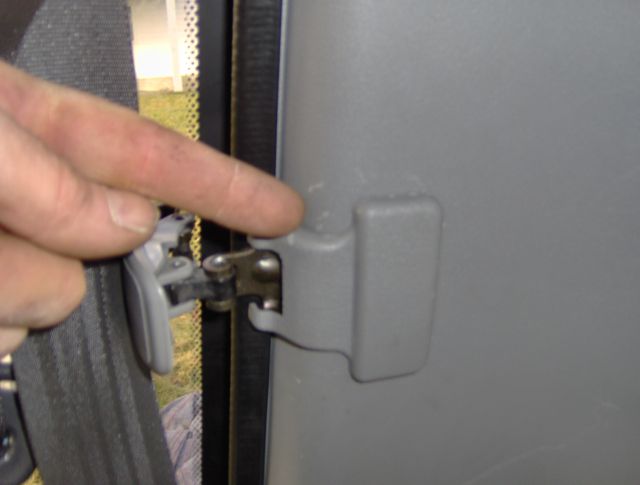

OK, so I tried the silicone trick and I was still seeing leaky pop-outs. All three of them. I'm certain this has been going on for some time as I pulled a 2006 Japanese newspaper from under the carpet shortly after getting Hazel home - it was totally saturated :? I considered getting used ones from ccautos, but figured I would likely have the same issue, if not now, then eventually, so I went to Rocky Mt. Imports for new ones. John warned me that the seals would be expensive, and he was right!! $150.00 EACH :o But not having to tie a tarp over the bus every night and not having water accumulate under the floor - Priceless. Had a nice morning yesterday, so I took a few minutes at our work-site and made the switch. When I tried the silicone I removed and replaced the windows as described above, but I guess I used too much lock-tight, 'cause I could not get them off this time. ccautos Glen advised me to simply leave the hinge attached to the windows and undo the screws that anchor the hinges to the bus - seems kinda obvious now... :oops: Thanks Glen :-) Anyway, the project went smooth, even for me! :? and after the rain last night there was NO WATER in the windows this morning!! Happy day! I urge everyone to have a careful look at their windows after a rain - I bet this syndrome is more common than people know :M :-D

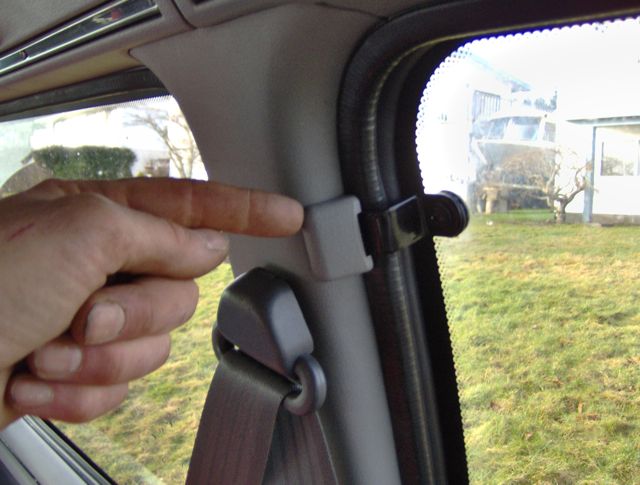

Just slide this little cover back to expose the big Phillips screws
Glen warned me that these may need an impact hammer to crack them, but lucky for me they came free with no trouble

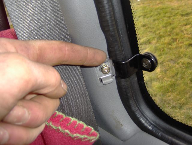

The rear, opener hinge

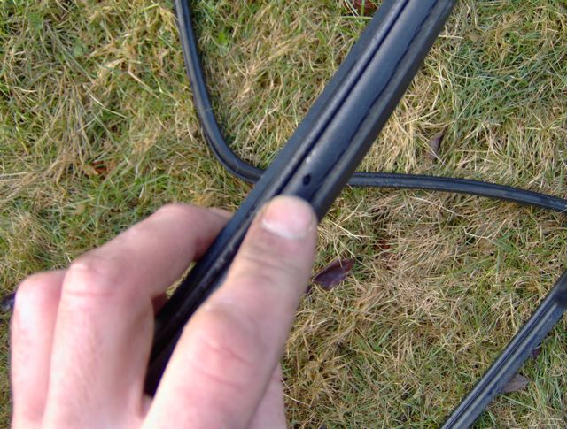

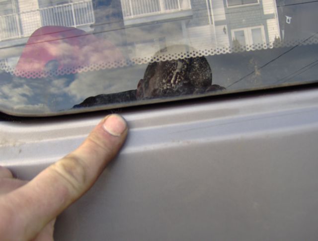

There are 4 of these little vent holes which must be placed along the bottom of the window - note the wear creases in the rubber
When reinstalling the windows make sure the glass in evenly centred
