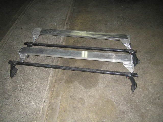

you have to be carefull, the roof really climbs high from front to back, we stoped trying to make racks fit and just build our own from scratch, but each bracket will hold over 500lbs , a bit over kill , but you sure dont have to worry about over loading them, your more likely to blow shocks than our roof racks lol
here is an example I like to call, Ours vs theirs
be carefull if you go with the uber expensive max weight of 50lbs you can buy from your local sveed shop.. 50lbs isent alot of weight lol
but how much will the gutters themselves hold in that surface area?

well on one set of roof racks with a saffari rack on them we have put 600lbs of gym weights and even given it a good shake side to side, then with me climing up onto the rack to pass the weights down thats an aditional 190 lbs on top, to if you overload your rain gutters then you have really really packed some weight on your roof, maybe not the best thing to do when cornering on a tall narrow van, but the racks sure held. and I was very happy.

Do you sell your brackets? and if so, for how much? I didn't see them for sale on your website...EnviroImports.com wrote:you have to be carefull, the roof really climbs high from front to back, we stoped trying to make racks fit and just build our own from scratch, but each bracket will hold over 500lbs , a bit over kill , but you sure dont have to worry about over loading them, your more likely to blow shocks than our roof racks lol

we dont sell the brackets seperatly, as they are actually Tig welded to be one piece, so what you get is the crossbar and brackets for each side, but its all 6061-t6 aircraft grade aluminium its a bit decieving from the pict, but its one piece so nothing come apart.
I had them on the site just befor we went to japan, but we sell out as soon as we make them , we have one set for a low roof van ready to go, but we just got back a few days ago and havent started welding anything yet.
in the next couple weeks we will have roof racks and a our own version of bull bars up on our site. if you want anything custom done let me know, its alot easier to put mods into the racks during production than after.
