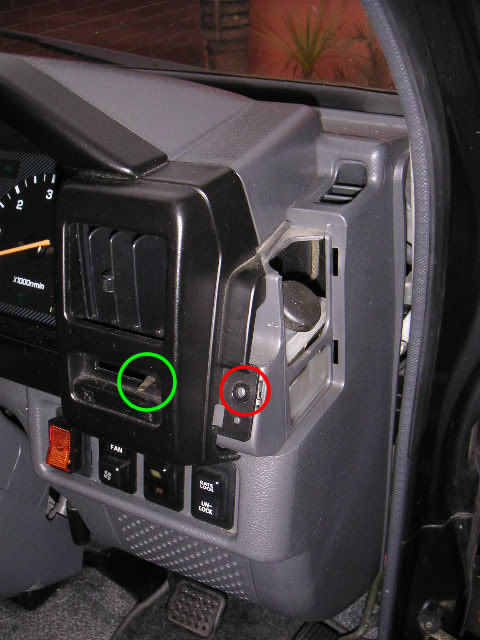

I guess there is some other part down by the slave cylinder I'm not familiar with. I don't know where to find the reservoir, even.
Stickyl clutch couldn't get it out of gear tonight
weelsey wrote:I don't know where to find the reservoir, even.
Brake and clutch fluid come from the same reservoir. It has a baffle inside so a leak in one system won't drain the other.
