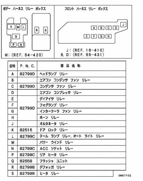

Try changing the tail lamp relay (L) under the dashboard- replace it with the power window relay temporarily and see if that fixes the problem. The relays just pull out, though you have to wiggle them while pulling to unlock the plastic latches.
(On some models the function of relay L and M might be reversed- check both of them, just in case)
Front harness relay box
A: Headlamp relay
B: A/C condenser fan relay
C: Condenser fan relay
D: A/C compressor relay
E: De-icer relay
F: Fog lamp relay
G: Intercooler fan relay
H: Horn relay
J: Alternator relay
Body harness relay box
K: Door lock relay
L: Tail lamp relay, auto light relay
M: Power window relay
N: Accessory socket relay
P: Rear heater relay
Q: Flasher unit
R: Defogger relay
S: Heater relay
