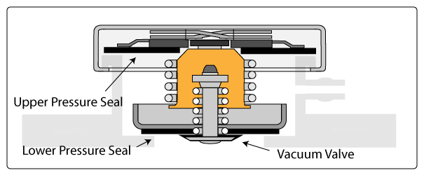

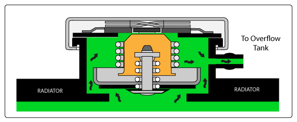

The coolant has to be going *somewhere* when it expands, and if it's not leaking onto the ground then it almost has to be coming out the radiator cap. (If it was going into the engine you'd definitely notice). I wonder if your new radiator takes a different cap to the standard one?
Standard Mitsubishi caps are unusually shallow- the "lower seal" is only about 1cm below the upper seal.
If your new radiator was designed for a taller cap, the lower seal might not contact the sealing surface in the radiator (or with not enough force to hold coolant pressure), and you'll have coolant going out the overflow as soon it expands, rather than building pressure first:
I'd measure the dimensions of the cap and the radiator neck, and make sure the lower seal will actually contact the sealing surface.
You could also try a test to see if the cap is holding any pressure at all: with the engine cold, try disconnecting the small black rubber overflow pipe (goes to the overflow tank) from beside the radiator cap. Start the engine and watch the overflow outlet as it warms up. If the radiator cap is good, you won't see coolant coming out the outlet until the temperature gauge is almost in the "normal" range. If the radiator cap isn't sealing properly, it will start to leak coolant almost immediately- certainly within a minute or two.
