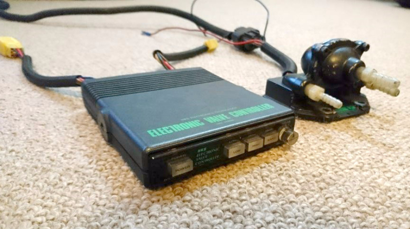

TL:DR; I've found an old-school HKS EVC2 boost controller, have fitted it, and it works beautifully. Highly recommended.
Previously I've made do with a DIY solution, basically a small pressure regulator and pressure relief valve like this:
http://www.autospeed.com/cms/article.html?&A=111348. It's cheap and quiet and reliable, but it was sensitive to temperature. When cold I'd be getting only 10psi of boost. A few minutes later it would make it to the preset 18psi and stay there most of the time, but when towing on a hot day it would allow 22psi.
I've tried a solenoid-valve style electronic controller (This one, because cheap: http://www.hybrid-power.com/_p/prd1/289 ... ller-ebc-r) which worked perfectly, except for the noise. A solenoid valve pulses constantly to control the wastegate actuator. An incessant farting, rattling noise might be ok if your engine is a couple of metres ahead of you, but when it's under your seat it's a bit intrusive. Our turbos are also *tiny* and very responsive- I could see the boost gauge fluttering from the actuator pulsing, and I suspect that wouldn't be good for the turbo in the long run.
The solution is the HKS EVC series of boost controllers- they use a stepper motor valve to regulate actuator pressure (except the "budget" EVC-S), and are fantastically quiet and smooth. They're also fantastically expensive: NZ$900 for the current EVC-6, which has a pretty screen and dozens of features I can't use because diesel. HKS has been making stepper motor boost controllers since the '90s but older models are unavailable. Nothing to be done about it... unless a boy racer crashes his late '90s Skyline GTR.

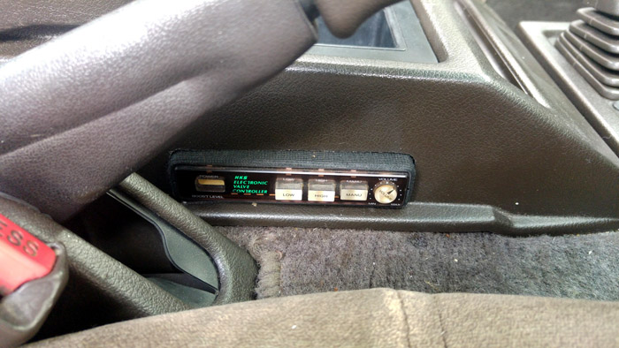

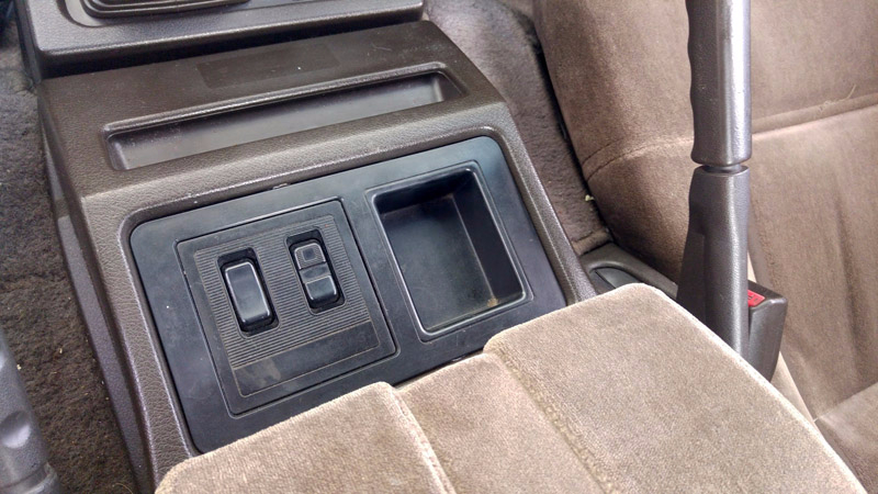

I've run out of dashboard space so it lives in the centre console. It's unobtrusive and out of the way, but easy to reach for adjustment. I've temporarily removed the power button because it was too easy to bump. High boost (20psi) for around town, low boost (14psi) for towing to minimise high-temperature ignition advance, manual mode for... dunno. Experimenting with fuelling and boost levels I expect.

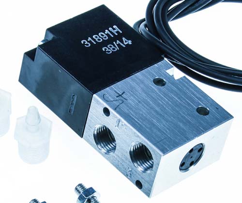

Just remember, you don't want an EVC-S. That's their budget-option solenoid valve controller. Avoid any controller that has one of these:

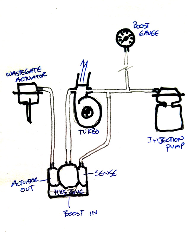

The HKS installation manual is aimed at petrol engines, diesels are a little different:
On a petrol engine you're mostly concerned about limiting how much boost the cylinders get, so you connect the sense port as close to the intake manifold as possible, after all the pressure-reducing pipework. A diesel doesn't really care about boost pressure*, we're more concerned with not destroying the turbo by overspeeding it, so we connect at the turbo outlet.

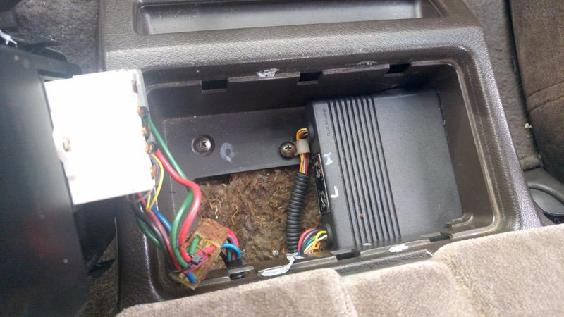

Morgonzo wrote:Is there a fab'd bracket under the console holding it?
I planned on it, but there was no room! It's *just* slim enough to fit between the coin tray and the base of the console, even then I had to rotate the power window switch panel 180 degrees:
There's a bit of double-sided tape under the controller (gross) but it's wedged in there tight enough that it doesn't move.
The other nice thing about mounting it in the centre console is I can get to the adjustment pots on the back while driving. Set to "low", find a long hill, full throttle, adjust until at desired setting. Repeat for "high" range.

Those photo's of the install are interesting because I do not have that much room. I have no power windows so the space is filled with the cup holder/spiller.

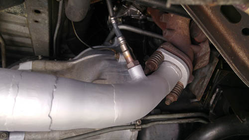

I don't think the stock downpipe is a bottleneck. Later model 4D56s with direct injection have a similar sized downpipe, and they make 180hp and 300lb.ft (stock ours made 80hp and 150lb.ft). The stock exhaust system is a nightmare, as you've noticed, but the downpipe seems fine.

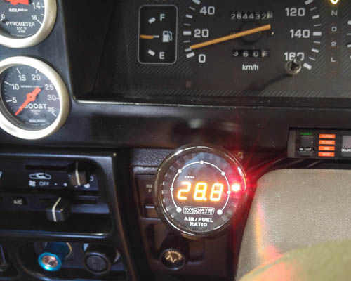

Better to spend the money on an EGT gauge, boost gauge, and a wideband air/fuel ratio gauge for easy tuning. There's a thought: make sure they add an O2 sensor bung to your exhaust, about a foot down from the mounting flange. An air/fuel gauge really makes tuning easy.

javabob wrote:I keep reading that our turbos should not be adjusted above 13psi.
Check out the link at the end of my previous post, the one with the plumbing diagram. In short, the stock turbo will do 14psi all day as long as it's below about 3500rpm. It'll handle up to 4000rpm, as long as you don't hold it there.
It'll do 17psi up to about 3250rpm, but beyond that the turbo's beyond the manufacturer's advised limits.
As I mentioned earlier, I've found that 17psi is plenty for the heavy hauling I do. 20psi is about the engine's limit without a different injection pump, but if you want that 20psi (for drag racing or want every last bit of power for around town cruising) then you'll need an uprated turbo.
I'd start with 17psi and get the hang of tuning the injection pump before you spend all the money on a new turbo. I'd also recommend getting a wideband oxygen sensor, it really does make tuning so much easier. An EGT gauge is useful, but the extra accuracy of an O2 sensor is lovely.

I have an Innovate Motorsports MTX-L wideband O2 gauge. It works fine, except it comes set up for gasoline. To change it to diesel you need to plug it into a computer with something called a "serial port". http://www.innovatemotorsports.com/prod ... l_plus.php
