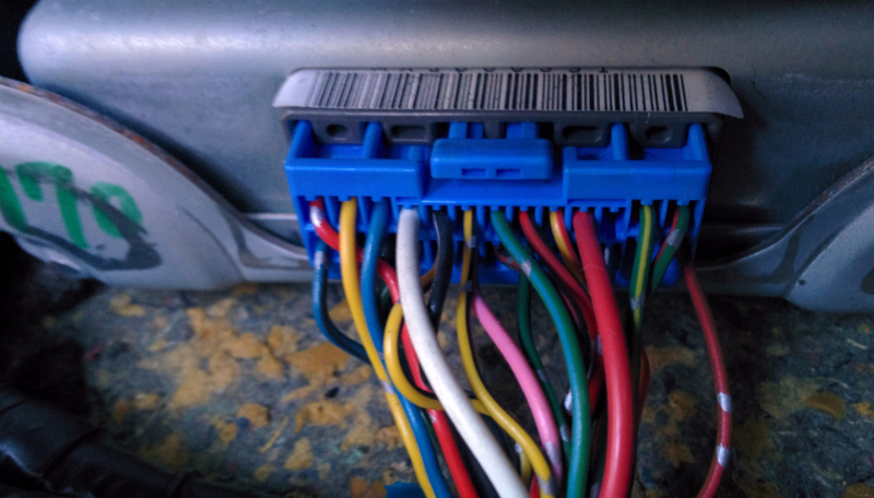

Ok...need some help guys. After chatting with some owners on DelicaClub.com, a few had mentioned looking into my coolant temperature sensor(s), because if they are faulty, it can prevent electronically controlled transmission from attempting to go into Overdrive. I have since swapped out both the engine coolant temperature gauge unit, and the engine coolant temperature sensor with OEM replacements from amayama.com. Unfortunately, this did not fix the issue with my lack of overdrive. Re-checked the Overdrive fuse under the dash (which is fine), and the O/D light comes on and off on the dash. Still running 3,500-ish rpms at 100km/hr though....so no 4th gear.
Any other suggestions?

Thanks guys! I will be taking it to the shop to be inspected on Wednesday, and they will see if they inadvertently messed something up while doing the oil change or tightening belts. I looked at everything I could and didn't see anything awry (but as I said I've already replaced the coolant temperature sensor as I had noticed the pin on the connector to the original sensor had been bent).
I've also taken the following steps (this excerpt from a post I just made on delicaclub). Based on the below info, do you guys have any additional suggestions/comments for me?:
I've read a bunch of threads now, including those noted at the bottom of this post (for your quick reference). I removed the steering column cover and inspected the wiring from the O/D switch to the point where it disappeared under the dash. Seemed ok to me...and I did disconnect, inspect, and reconnect at the steering column clip connector. Once again, worth noting that the O/D light does turn on and off as it is supposed to, and the fuse isn't blown. I also tried driving it at highway speed with Overdrive enabled (and disabled) while pressing and holding the overdrive button (as some people reported internal spring issues in button switch mechanism). Doesn't matter what I did, it still runs at 3500ish rpms at 100 km/h (no 4th gear). So then I removed the center console cover so that I could see the PIN connector for the ECU. See picture I have attached of my ECU pin connector. Based on the only information I currently have to go on (from post #4 below), the Overdrive wire arrives at the ECU as Red/Black at PIN #8 (top row about halfway along). Can anyone confirm that for me? (for a 96 L400 Series One Super Exceed from Japan - PF6W chassis - 3.0L V6).
I'm completely out of my element when it comes to testing electrical circuits, particularly automotive circuits...but I do have a multimeter. Can anyone kindly provide a how-to-test-this-pin-connection step-by-step? I'm taking it into a local shop on Wednesday, but I figured if I can at least determine that it is working properly up till the ECU, then the mechanic can concentrate on the stuff past that, including the solenoid inspection and testing, and also making sure that the guy that tightened the belts and did the oil change didn't screw something up inadvertently a few weeks back. If we test all of these things, and can't determine the issue, then I will have to assume it is something more serious inside the gearbox/transmission itself *gulp*.

- My ECU pin connector - is OD red/black at PIN 8 (top row about halfway along?)
- 05 - OD SW Wiring ECU (web).jpg (411.82 KiB) Viewed 7588 times

I believe the problem is the overdrive switch on steering column's gear selector itself. Although the "O/D Off" light on the dash does go on and off as expected, and the O/D switch 'feels' fine, I believe that when overdrive is switched on, the switch on the gear selector is not switching the circuit properly and therefore not feeding 12V to Pin 8 on the ECU as it should to tell the ECU that overdrive is on. Does this sound probable to everyone?
If so, I think I want to bypass the O/D selector switch with a single-pole-double-throw (SPDT) toggle switch in one of the spare switch positions on the dash. Has anyone done that and can tell me where they sourced a toggle switch that looks factory-like and fits like a glove into one of the spots on the dash?
Thoughts?
Thoughts?

It sounds like a reasonable hypothesis. Could you try connecting +12V to pin 8, just to be sure it cures the problem?
