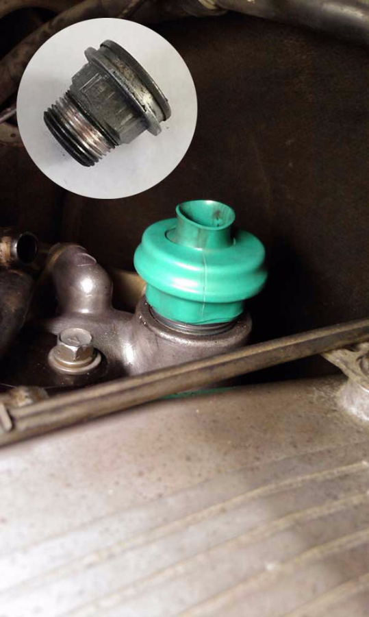

crazy4two wrote: As I step on it it almost sounds like an exhaust leak.
The over-pressure dump valve? When I got mine it was popping at ~ 8-10psi boost so even a minor incline was an issue. Replaced it w/ a new one which pops at ~ 13psi. Secured it so that it can't pop and I max out at ~ 16psi...
Steven
1991 L300
Harrisburg, PA
Lack of power and black smoke.
sk66 wrote:The over-pressure dump valve?
You might be onto something there. A pressure relief valve that's opening too easily would account for the symptoms: Works fine until it pops, and then black smoke because the injection pump doesn't know that most of the air isn't making it to the cylinders.
I'd try wrapping it tightly in electrical tape (lots of tape) to temporarily seal it, and see if it makes a difference. It's on the inlet manifold at the back, and you can *just* reach it without removing the drivers side engine cover. Here's a picture of mine sealed up/disabled with green heatshrink (and an inset of what it looks like when removed):
And a severe lack of power. For some reason when it pops it's not "regulated," the boost pressure will drop well below the pop-off point... at least mine did.
