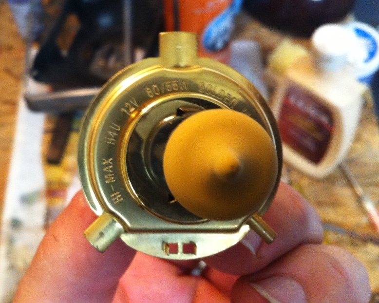

Tomaboyd I'm with you 100% my headlights are horrible. So Growlerbearnz I'm going to take your advice.... again and order some Philips Xtreme visions. My question is since I have the old rectangular headlights: Do I need a different type bulb for the hi and low? My outer low bulb is this:
oooohhhh GOLD!!! :-D actually Golden Platinum White to be exact.
I assume an H4U fitting of this bulb is the same as an H4 of the Phillips.

I'm not hugely familiar with the pre-facelift rectangular lamps. You'll probably need two different kinds of bulb. I believe the outer lamps do high and low beam (which would be H4) but the inner lamp only comes on for high beam (probably H1). I'd remove both sets of lamps and make sure.
H4 and H4U appear to be the same thing.

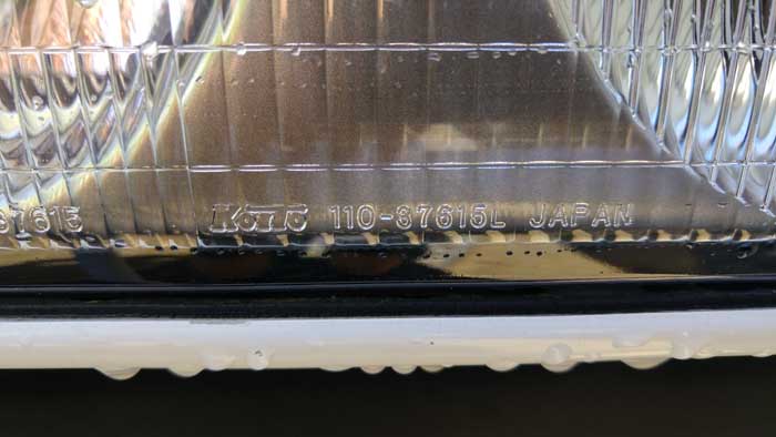

It's just occurred to me that your headlamps are probably aftermarket right-hand traffic units (Depo brand, if I had to guess)- so the optics may well suck. The Philips X-treme Vision bulbs really do put out a lot more light though, so they should be an improvement. (Osram Nightbreakers are pretty good too, but not as good as the Philips bulbs).
If they're still the original Japanese left-hand traffic units (Koito 37615, glass lenses) the light beam is the wrong shape for driving on the right- more suckage.
Just for reference: Factory LH-Traffic L300 Koito facelift headlamps use H1 on the high beam, H3 on the projector beam- it's imprinted in the glass. Only just noticed that this morning :-)

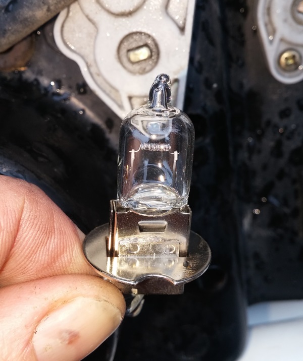

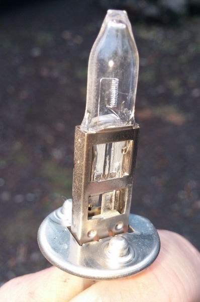

Hey! Recharging this Zombie. I have scoured all the lightbulbs posts and I hear a lot of "oh, just chuck in these phillips extreme, yadda, yadda". I've replaced a lot of various bulbs in my life, but never have I seen any that look like this:
I don't see how the standard bulbs just stuff in here. Any ideas? Thanks in advance.
1991 L300 TD Low Roof
1992 L300 TD Low Roof
1992 L300 TD High Roof
LED Headlight Bulbs
Those are the correct bulbs for projector-lens Delica headlamps. H3 is the shorter one and goes in your low beam projector lamp, H1 is the taller one and goes in the high beam lamp (it looks like you've got fingerprints on the glass though, which is naughty- clean that off before installing).
Which part of installation are you stuck on? It looks like you've managed to remove the headlamp units, now unscrew the two circular grey* covers from the back, unlatch the springy bit of wire which hooks under the metal collar to hold the bulb in, unplug the bulb. Installation is the reverse of disassembly ;-)
*they're grey on OEM headlamp units. Your mileage may vary. Feel free to share photos if your setup is so unusual that these instructions don't make sense.

Post by ynwa »
Oh hey, no issues with installation, those are the stockers. I want to replace the ones that I'm holding with a better product. TBH, I hadn't looked just yet. All the bulbs I see tossed around the board are the more modern 3-pronged, halogen type. The PO actually had a set, but after examining the bulbs, they are entirely dis-similar.
Any part numbers for decent replacements for the OEM's?
Thanks!

LED Headlight Bulbs
Ah! Right. Delicas before 1990(ish) have rectangular semi-sealed beam headlamps which take the larger bulbs (and that's what they were talking about above, I think). If you've got the all-in-one curved headlamp with projector low beam (1990-ish and later) you'll need a pair of H1 and H3 bulbs instead.
I have Philips X-treme Vision H1s (https://www.amazon.com/Philips-X-Treme- ... B004G395NU) and Osram Nightbreaker H3s (https://www.amazon.com/OSRAM-Night-Brea ... B00FQ8AQI2).
Philips do a "Crystal Vision" H3 which is as bright as the X-treme Vision, but they have a blue tint which reduces light output and makes you look like a twat.
