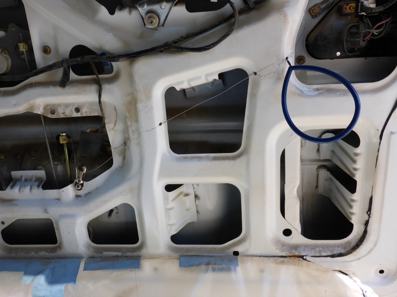

Just follow the pictures, remove the strap closure and pop off the tailgate cover. Remove the plastic film that covers the door frame.
P1020330 (800x600).jpg (248.1 KiB) Viewed 2725 times

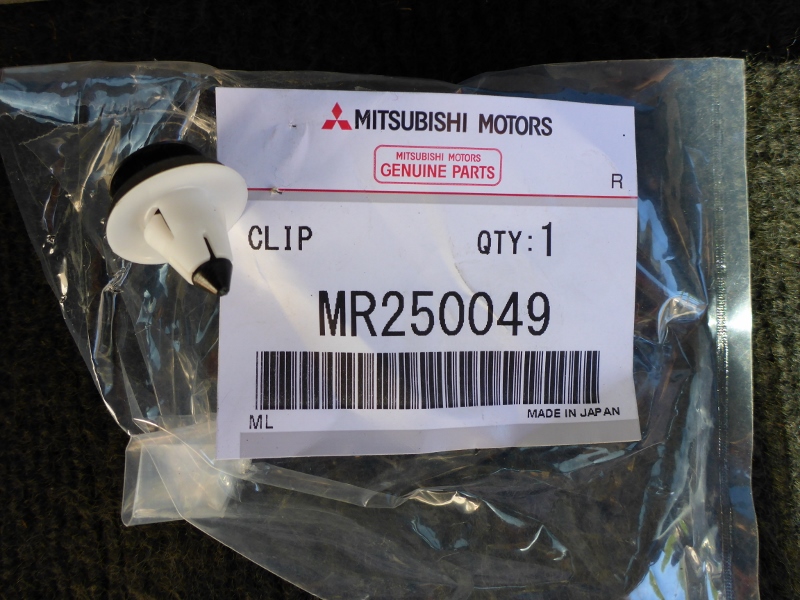

The 6 plastic 2 pce. closers can't be reused. Just order new ones, see the mitsu number. The other plastic closers are okay but the main ones are usually hooped.
P1020328 (800x600).jpg (273.05 KiB) Viewed 2725 times

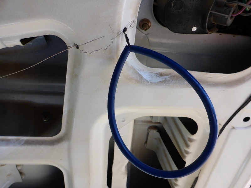

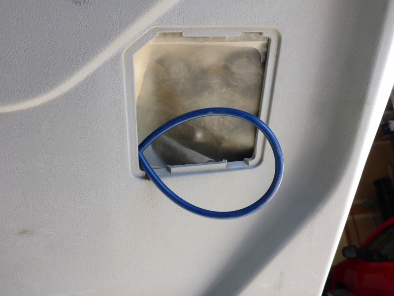

I used stainless cable (attached to the top of the door rod) and a small pulley bolted to the frame then drilled a few extra holes for a straight run and left the handle hidden inside the little door for changing your taillight bulbs.
P1020329 (800x600).jpg (227.31 KiB) Viewed 2725 times
The cable is joined with downrigger copper tubes and the handle is tubing from my air bag lines.
P1020327 (800x600).jpg (205.36 KiB) Viewed 2725 times

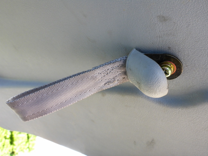

An extra picture.
P1020331 (800x600).jpg (255.37 KiB) Viewed 2725 times
Replace the plastic, the new clips , pop the plastic cover back on and screw on the strap handle. Presto and now the door can be opened from the inside.
