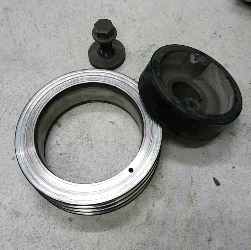

My Deli blew it's Crank Pulley this morning. Oh what fun!!! (Not!)
I did pull everything apart and ordered new bits but I think I'll mount my gopro clone and cronicle the install via time lapse.

The Deli's crank pully is comprised of: The inner core which has a rubber ring injection molded to it at the manufacturer....and an outer ring that drives the belts. The outer ring is pressed over the rubber ring with the help of water based lube that dries and allows the rubber to grab the pulley ring tight.
Over time the rubber starts to dry out due to age and heat from the engine and that bond gets weaker allowing the pulley section to move...usually towards the radiator and clutch fan but not always as they can move backwards towards the engine.
So how serious is this? Very and if your Deli is 20-years old chances are this is a problem that will show up with little warning. Testing is by pry bar. If the pulley moves off the core with gentle pressure then you need a new pulley.
My first indicator of a problem started with a strange squeak about a week ago which I thought was a sticky AC idler belt pulley. Did that repair and the noise changed but didn't go away.
April 30-Saturday AM I started the engine and heard what sounded like a hockey card in bicycle spokes.....the pulley had moved forward 1.5 inches and was hitting the clutch fan. I was lucky....this happened at home in the garage. When I tore it down I noticed the pulley did rub against the timing cover before moving forward (that was the squeak I was hearing). Luckily the cover is okay. So now I wait for parts...pulley, crank seal and new belts.
If you have the tools and skills this is a basic job but there is lots to remove just to get at the pulley...wait for the time lapse and you'll see.

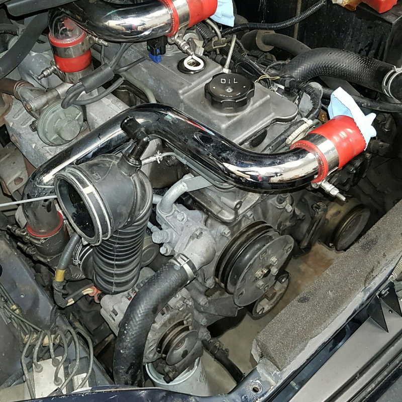

Just a heads-up but in that 2nd photo it looks like your 710 cap is on upside-down. I went and checked my van and it had the same problem, but it is now fixed.

Also, just a heads-up but in that 2nd photo it looks like your 710 cap is on upside-down. I went and checked my van and it had the same problem, but it's now fixed.

What and where is a 710 cap?

It's from a "blond joke" that dates back to when Noah was building the ark: 710 = OIL (upside down).DeliTan wrote:Hi Folks;
What and where is a 710 cap?...
