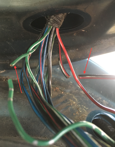

My rear defrost isn't working.
The light on the defrost switch comes on but I'm not getting power to the defrost on the back (checked with a multimeter). The circuit on the window is fine.
Checked the fuses and they seem fine too.
Anybody have this problem? And ideas?
I have a feeling that it is a broken wire, anybody have any suggestions where to start?

had the same problem, turned out to be a broken wire in the rummer boot where the wire goes from the door to the body of the van. right side.
Screen Shot 2016-04-08 at 4.27.37 PM.png (334.46 KiB) Viewed 3317 times
Thanks for the info jos_mclean.
The broken wire was just where you said it would be. Probably broken from the opening and closing of the rear hatch.
I have attached a pic. The rear defroster wire is black with a red tracer.
I found another broken wire in there as well. A green wire with silver stripes. This turned out to be for the right side back up light.
All soldered up and everything works like a charm.
The pic is of the wires inside the rubber boot which is at the top right side of the rear hatch.
