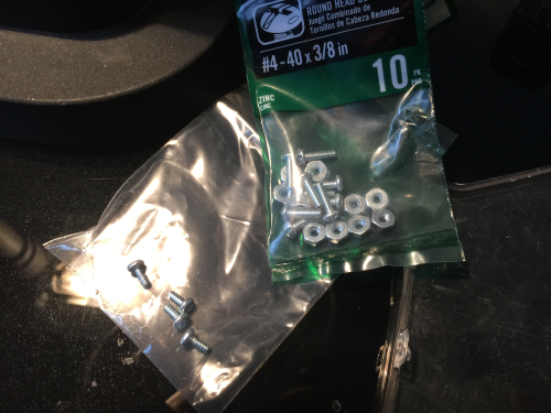

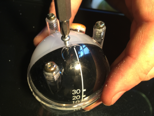

My gimbal still had fluid, so not a problem, but the little plastic bit that kept it in place was gone.. I went out and bought some of the smallest machine screws I could find:
Luck found me smaller screws
You can see I bought #4-40 screws - and just as I was about to use these, I stumbled across this packet of other screws in my toolbox, they are shorter and slightly thinner - I don't know what size they are, but I would guess #2 or #3.

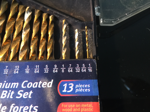

I started drilling with a 1/16" bit, very very slowly. Then I moved up to a 5/64" drill bit, as it just fit the screws.
Only the two smallest bits were used

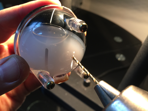

I drilled very very slowly and cautiously.
Drilling Slowly
Drilling Slowly
I kept the air by the hole to try to prevent leaks, it actually worked!
drilled very carefully into spot where the support once was
The screw thread was able to bite into the plastic and keep the fluid from leaking. I had to carefully adjust the screw depth:
Slowly drive screw
Slowly drive screw

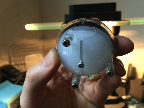

Next, I had to spin the ball all over the place - I waited to do this in this manner so I did not spill fluid all over the place. It took a good bit of turning and shaking to get the screw lined up with the slot!
screw in line
screw in line

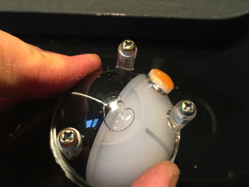

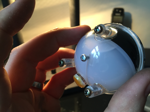

The next bit took a little finesse. I had to turn the screw in just enough to catch the slot - but not so much that the ball would not be able to move. It was a very gentle operation. In the end, I found myself adjusting by 1/32 degree turns of the screwdriver. That is how tiny of an adjustment I needed to get it right.
And it all worked!
Mr. Flibble
Posts: 1397
Re: How to repair your gimbal/inclinometer
Post by Mr. Flibble »

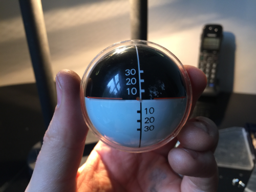

One fixed gimbal!
