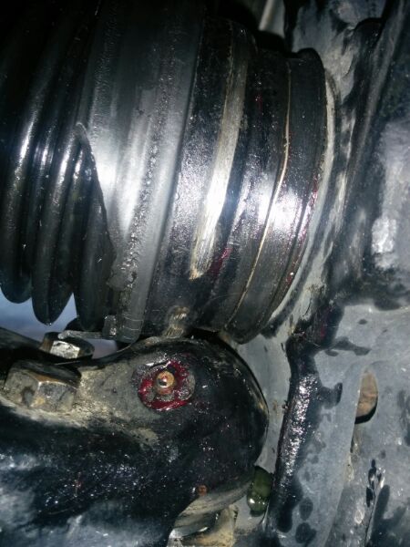

Hello All
It all started with both inner boots torn. I sourced all four boots, pulled the axles, installed the boots, and reinstalled the axles. Now the outer boot protector sleeve is rubbing the lower control arm on both sides. I did notice that there was very little clearance before I got started but no rubbing. Not sure what went wrong. Could an alignment fix this? Maybe the lower ball joint portion of the control arm got bent somehow during the removal process???
Any thoughts would be greatly appreciated!

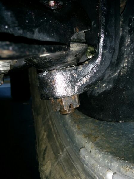

The lower ball joint was one of my original suspects. It "appears" to be seated correctly, threads protruding and cotter pin hole lined up. I did take the pin out to graunch another flat to line up with the hole, it was tight. Here is a close up pic:

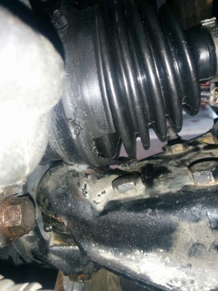

I think I found the problem. The wheel side boot protector sleeve might not be seated correctly on the CV joint. I think that it has to be pushed in, away from the wheel which would give it just enough clearance. Would someone be so kind to take a picture of their CV boot/protector sleeve and post it. Please pay particular attention to the base where it meets the knuckle.

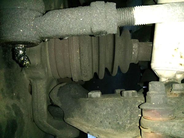

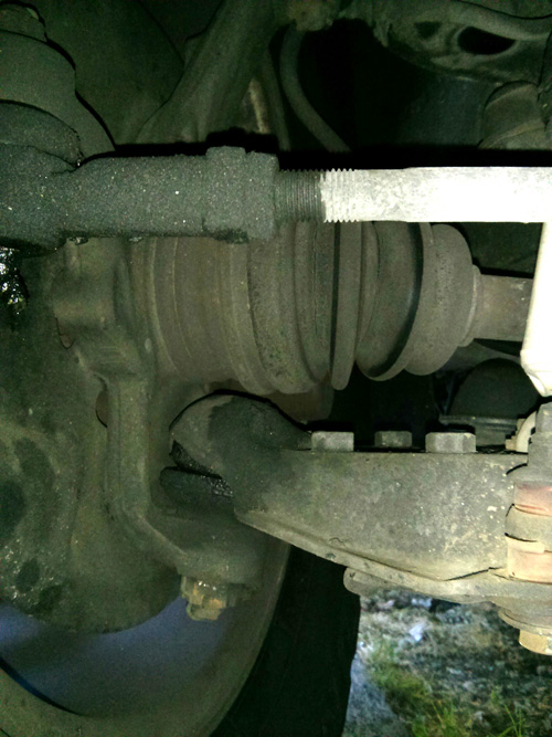

Re: CV Boot Rubbing on Lower Control Arm
My CV boots are original- no protector sleeve (unless I'm looking at the wrong thing.)
