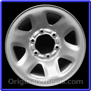

Bought a set of 15x8 steel wheels from a Toyota 4-Runner. The center hole wasn't big enough to fit over the axle stub and 4WD hubs so dropped them off at a local wheel repair shop for a little machining.
108.5mm hole is needed to clear the L400's hubs. These are just under 106.

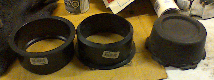

Nissan has a nice basic black center cap that locks in against the wheel nuts. Wreckers have these for 2-3$ each. Silver caps are also available from the early model Xterra. (New $20 each)

Front hubs were way too big for the Nissan 4WD caps...(dam!) Discovered a 4" ABS plumbing adaptor that will work (Check.....Watch for the modifications)

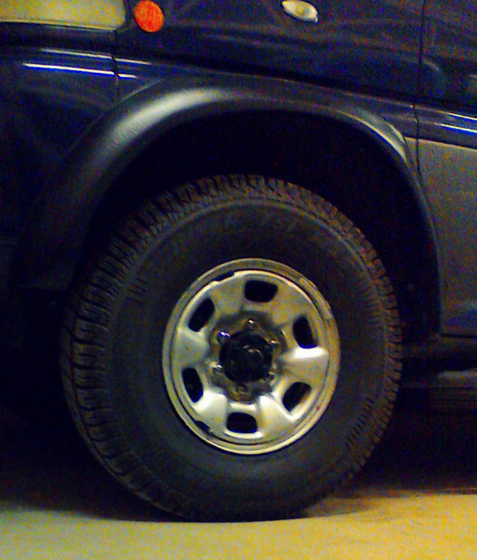

Pictures or it didn't happen :-)
Big-Bird
Posts: 1218
Vehicle: 96 PE8W Spacegear
Re: Wheel Modifications
Post by Big-Bird »
One to whet the appetite....it was too dark to get a good photo when I was done last night. The change from 30's to 31's is long overdue.
The plumbing parts (which will be the front wheel caps) are not modified yet. Need to dremel the flange and the inner lip in 6 spots each to fit around the 6 wheel studs and the 6 hub flange bolts.
