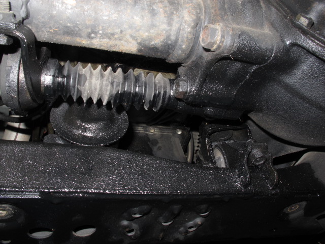

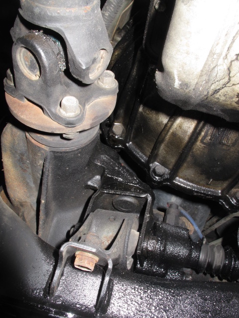

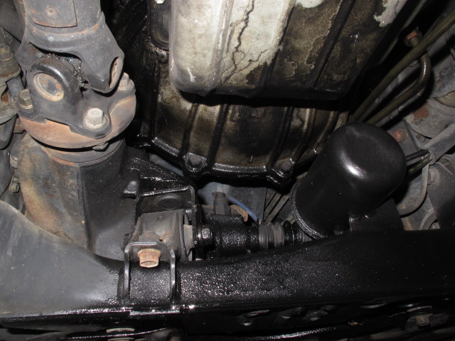

So, I was poking around under the Delica today and I noticed a fair amount of oil on a whole bunch of the underside!!
Here are some pics looking forward from behind the engine:
...and looking back from the front with the skid plates taken off:
I'm not particularly mechanically-inclined; the Delica is my headfirst dive into it. Any ideas on where should I start looking for leaks? Is there a "most likely candidate"?

Check the valve cover gasket. Common problem.

My money is on the half moon seal at the back the valve cover. Probably a lack of sealant.
and yeah common leak.....very messy but easy to fix with basic hand tools.
