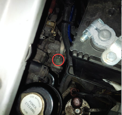

Here's a pic of the location of the low pressure nipple.
This is on my L400 with a single battery.

Thank you, with your picture I fund my plugue easly. But it is already full. I plugued my 12a refill and the pressure is already at 70psi. More than full. But I didn't let the engin running with the A/C fully open. I guest it is enought 70psi.

I used the 12a refrigerent kit from Canadian tire and the plugue fit great. I used the green plugue that izack98 shown to me. On the package they say to fill till 30 to 38 PSI, I don't know if each car is different. How your A/C work, went you are on park and let the A/C working. Is the air become warmer?? Colder then the outside temp but the air become colder while I drive.
