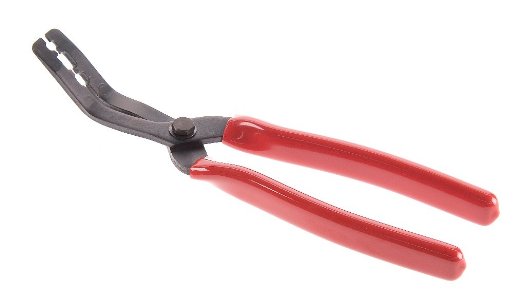

Body Panel Plyers are your best friend to gently release the plastic bits with little to no damage, this will ensure most of the clips get reused but there will be some damage as time does cause some plastics to become brittle, even the ones that never see sunlight can get brittle from heat/cold exposure.
