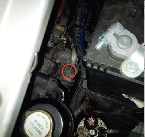

I was working on mine today. The low pressure valve is about 3" back form the power steering reservoir, and straight down. Mine has a green cap marked with an 'L' on the top. I took the inter-cooler off and that made it easier to access.
See the attached pic.
Anyone know of a good A/C shop? I think I have a leak and need more than what I can do with the kit.

Aaa thank you so much. Managed to hook it up with the intercooler still attached, had to do some funky contortions. Recharged the system this morning, no hissing sounds so that was nice. Looks like you need 3 cans of red tek to do the whole system, mine isn't quite at the right pressure with 2. Now lets see how long this A/C lasts.
