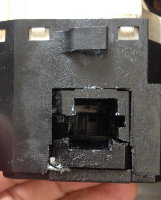

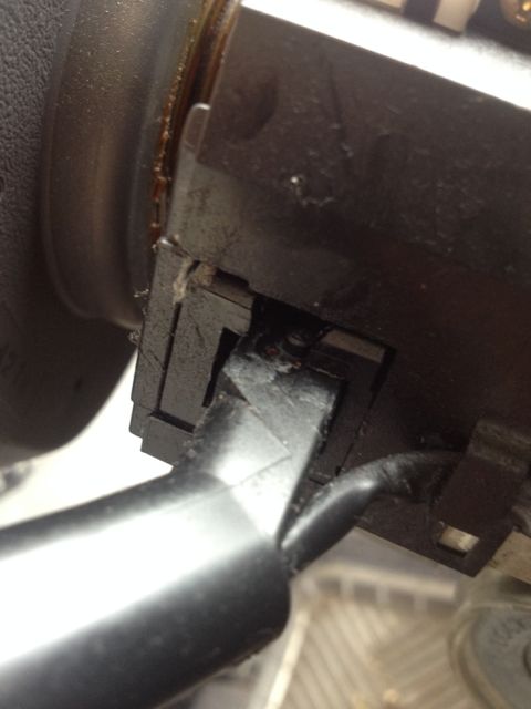

Hi Folks;
I could use the whole sub assembly but really only need the part that holds the turn signal arm.
If you have one in the Vancouver area, I would be pleased to pull it myself.

OK. So no response, and finding one at a dealer is unaffordable (for me). I guess I will check out off-shore sources. Apparently this part breaks often. Once I have a replacement for the offending piece, I will look into printing replacements with a 3D printer. I could do this from a broken one but mine is shattered and incomplete

Re: L400 (early) turn sig switch parts
Hi Folks;
For the sake of completeness, I am posting that I found a repair to this issue. It may not work for you, depending on your actual problem and your interest in dismantling the system.
I bought a replacement turn signal assembly as suggested by CREGAN (thanx again).
Part# B007TYPU5U from Amazon.com for $33.08 US$
Once I had the 2 side by side, I could see several differences. I had hoped to use most of the new one but, due to several electrical differences, I ended up using only the damaged part's replacement. However It wasn't an exact fit. I needed to trim some plastic off 4 separate locations in order to make it fit and work smoothly.
Although I have many hours into this project, I feel now it could be done in an hour or so...
Shoulda taken pix. Doh!
john
john
