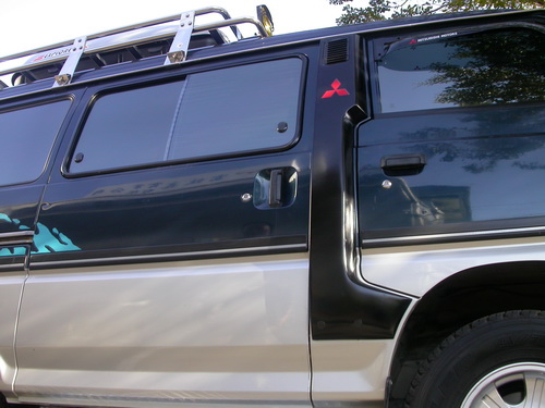

I have always thought that the stock snorkel is pretty low profile, in fact I'd call it pretty stealth. Here's an interesting thread to read: http://www.delica.ca/forum/mystery-mach ... -1859.html
I've been through three feet of water and had no issues. Take a close look at your stock air filter system: First you have the spill-off, where the pipes do not connect; then the air passage travels down to the dust trap that is equipped with a one way valve, before it goes up through the filter element.

To get some perspective on this matter: The air intake system is in a compartment that is located just below your derriere as you sit in the driver's seat. From what I've observed this compartment works like an inverted glass being pushed into water, keeping the air inside the glass. I'm not sure how long this bubble will last but evidently it lasted for over a mile for the Mystery Machine.
Many Delicas have snorkels but I'm not so sure how necessary they are.

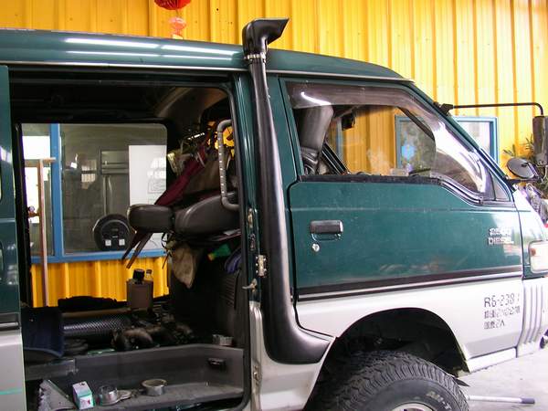

Jimny Bits out of Staffordshire England has the same snorkel for £249.00
http://www.jimnybits.co.uk/shop/other-4 ... d_607.html
DELICA L300 snorkel 3.JPG (72.63 KiB) Viewed 10493 times
Then there's this model from a Taiwan distributor...price unknown.
(This shop also carries the unit shown above, no price is shown though.)
http://www.fts4x4.com/en/products/?method=detail&aid=65

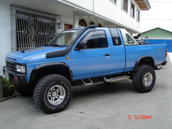

A little searching this morning did uncover a method to make a snorkel using foam board (the pink/blue stuff from home depot) , adhesive files/sandpaper, fiberglass and resins, bondo and paint and a proper snorkel intake goose neck. Could inspire someone to be creative for not a lot of money! 8-)
Working with foam to make a plug mold is easy and cheap. Ever put papermache' over a balloon? Similar principle. A chemical is used to dissolve the foam once the fiberglass/carbon fiber work is done.
A link on the IH8MUD site shows the how-to in a fair amount of detail. All a person needs is time and a few basic tools and about $60-70 worth of raw materials. The site is being upgraded on March 18th so there are no guarantees this info will be available when the site resets a few days later. Suggest you save the webpage on your own system so you know what this guy did to make a snorkel.
http://forum.ih8mud.com/60-series-wagon ... orkel.html
I am inspired to make a low profile unit for my L400 similar to the one made for Nissan's late 80's through mid 90's Hardbody Pickup.
