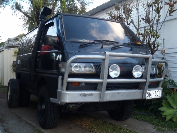

As much as I like to refer to it as a "Bambie Bar", in reality it's a "bush bar". Think about it. You are travelling at 110 KPH in your two tonne Delica and suddenly appearing directly in front of you is a three thousand pound bull moose. What would be the potential consequences of this engagement?
Rig Burns After Hitting Moose On Hwy 17.
And direct from the Darwin runners up catagory:

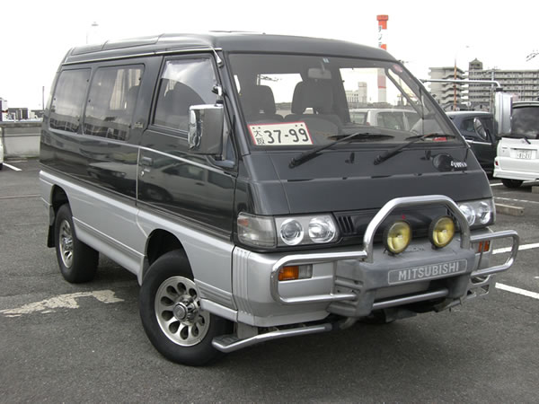

The stock tube type bull bars offer little to no protection....they are not structurally built to take anything over slow parking lot bumps. The tubes and thin plate steel bend as they are not fully supported on all corners like a true bull-bar.
Stock unit offers some protection to the nose, again for slow speed bumps and the integrated steps protect part of the Deli's cooling system....a few overzealous L300 owners have damaged the steps while offroading and have done significant secondary damage.

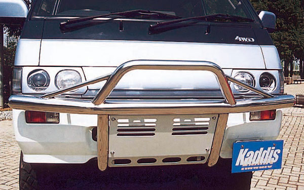

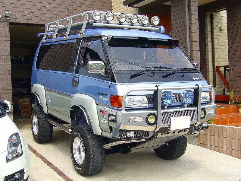

If you are thinking winch mount heres a couple of ideas.
There at least 2 Alberta fab shops that I have dealt with who can custom fabricate a full plate bumper in place of the stock plastic wrapped unit. (One works with steel, the other with 6061 Aluminum)

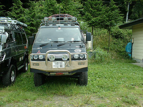

here's a tube type that is properly supported...not a winch mount type though.
