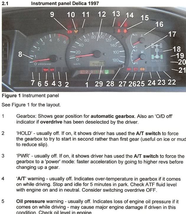

I did some further checking: According to the Aussie club guys the AT dash light comes on when tranny fluid temps inside the gearbox are high (we know that part). They do have some recommended actions to address this in the attached photo but it's important to note that tranny fluid is pumped through a coolant transfer tank inside the lower tank of the radiator...If the coolant temp gets too high it can't carry excess heat away which could trigger the AT light as well. Your high temp issue may have more do with the coolant system..... I think your light flicker means the warning system is working right and that you have some checking to perform (see below)
COOLANT SYSTEM CHECKS
- Check your radiator for dirt buildup between the cooling fins.
Check your clutch fan for proper operation.
Loose Belt tension on the water pump pulley and fan.
Radiator has an internal blockage so less coolant is flowing through.
A restriction of airflow through the rad. (big flood lights, paper, damaged cooling fins).
Thermostat is faulty or the wrong temp range for the Delica L400.
(Can't use a Pajero thermostat due to its higher temp range. Paj's have a thicker radiator than a Delica).
Air trapped in the cooling system. (Remove the plastic breather cap for the cooling system which sits above the batteries next to the fresh air intake for the interior hvac system.)
