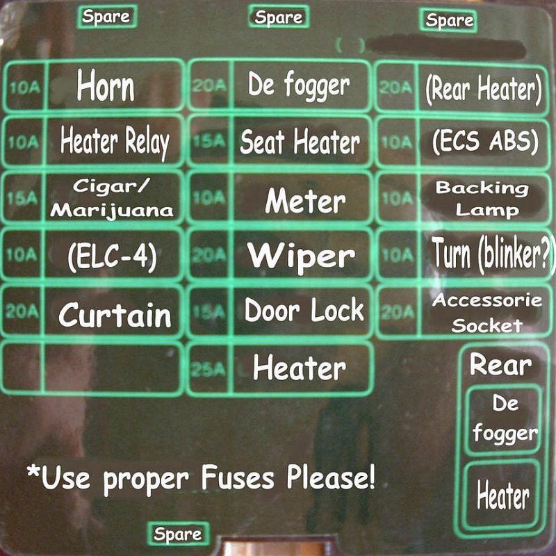

Starting with the least pain and cheapest cost:
Assuming the locks work manually when you activate the switch on the door. If not then a fuse it at fault, look under the dash. Easy fix There is also a keyfob activated relay under the dash that can fail. The relay can fail in lock mode, unlock mode, or both. If you have partial keyfob control then you should be able to locate the relay and just replace it. Sorry not sure of its exact location.
If the door-lock fuse is okay and the relay is also okay then you may need to reset the receiver. The radio receiver unit on the L400 resides in behind the panel aft of the rear heater...way back! Yep its in the wall and its a crappy place for this to be. The receiver has a set of buttons for pairing remotes to the L400 entry system. I'll have find the button sequence but I recall its very simple.
If all that still fails then there more involved issues that require parts replacement or patience to track down a bad connection.
