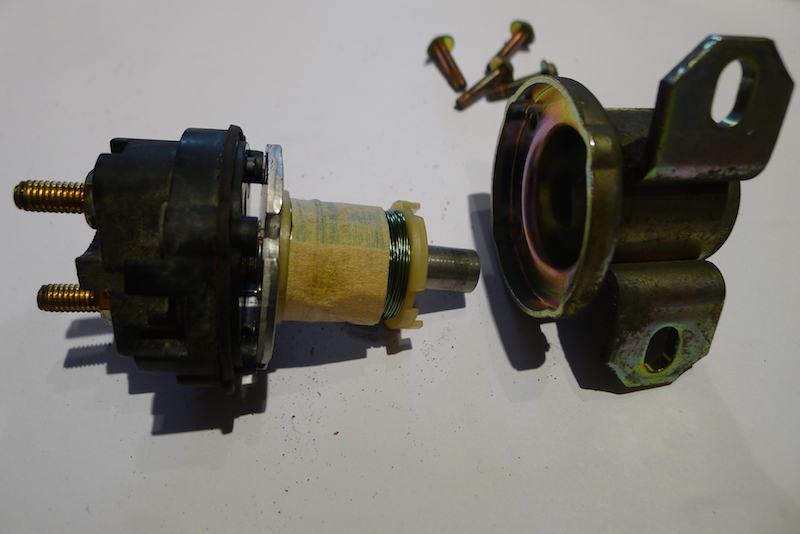

OK so the problem is back again. 1 click then nothing. No Power to the Bus Bar. Even the manual bypass does nothing.
I can get it going by applying power directly to the bus bar via a battery booster box.
So I pulled the Glow Plug Relays out, opened them up. They both looked good. Tested them. They both click and test fine.
Then I put them back in, hooked them up and Broooom, 2 clicks and it starts up no problem. That's from a cold start from the previous day.
Closed it up and then..... dead again. 1 click then nothing. This is the 2nd time I've gone thru all of this.

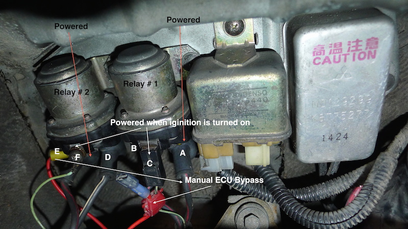

I'm thinking it's the 2nd Relay.
You can see in the photos. I get constant power to both relays, power to the middle line when the key is turned and a click from
Relay # 1. No click from Relay #2. I checked the starter relay and it checks out but will test again.
If it's the water temp sensor my thought is it should still allow the manual bypass to work.
The Manual Bypass has worked since it was installed.
If it's the Starter Relay would that stop the Manual Bypass?
The ECU is working and shouldn't stop the Manual Bypass.
If it's the glow plugs why is there no power going to the Bus Bar at least?
Wires are all hooked up snug to the bus bar.
So I am a bit stumped. A loose wire? It works sporadically.
I'll try to switch the relays to see how they behave.
Am I correct that "A" has power from the Battery.
When "C" receives power as the Ignition is turned then "B" sends power to the bus bar.
Same for "E,F,D". The 2nd sounding click is when the power is turned off to the glow plugs?
It doesn't appear that power is transferring to "D".
Thanks for any help out there.
- Relay Open.JPG (180.54 KiB) Viewed 6316 times
- Glow Plug System.JPG (192.93 KiB) Viewed 6316 times

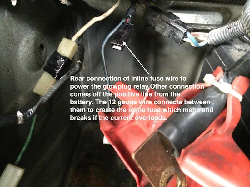

Success! Sunday sunshine brought a breakthru. Literally.
So knowing that there was 12 volts heading to the glowplug relays but it would drop to 0 volts when the relays clicked in
and knowing that if I jumped power directly to the bus bar it would start I started the search again.
Batteries volts checked out. I started again at the battery and worked forward from there.

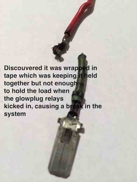

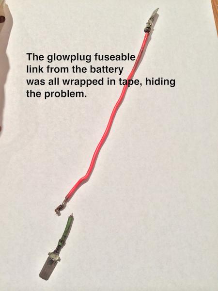

I had checked the fuseable link already and it tested good but this time I unwrapped the whole wire and found the culprit.
Someone earlier in life had taped it up because they had done a shitty patch job on the link. Beneath the layers of tape I found a
wire held together with a few strands.
Enough to allow a little power to move thru but when the relays pulled more the wire would heat and melt apart, cooling it would connect just enough to close the circuit again.
Some new 12 gauge wire and reused connections from the old wire and she fired up first try. 2 clicks.
I unplugged the wire which caused the same symptoms , plugged it in and BINGO!
2 full days of driving and dozens of start ups no problem.
Just read the last post on the other topic of not-starting and they had almost the same find! Hurray!
Here are some photos of the culprit. Thanks to everyone and the fantastic info on this site.
Cheers.
