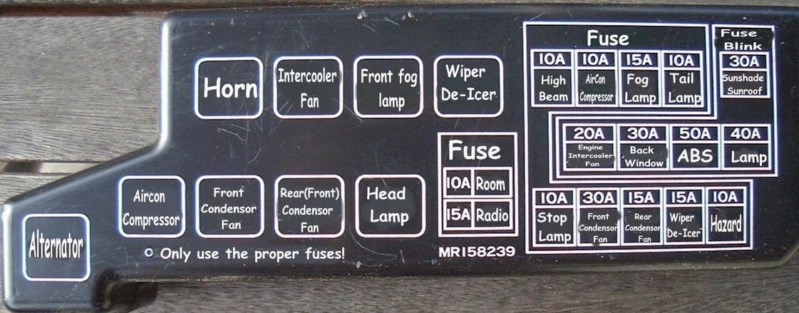

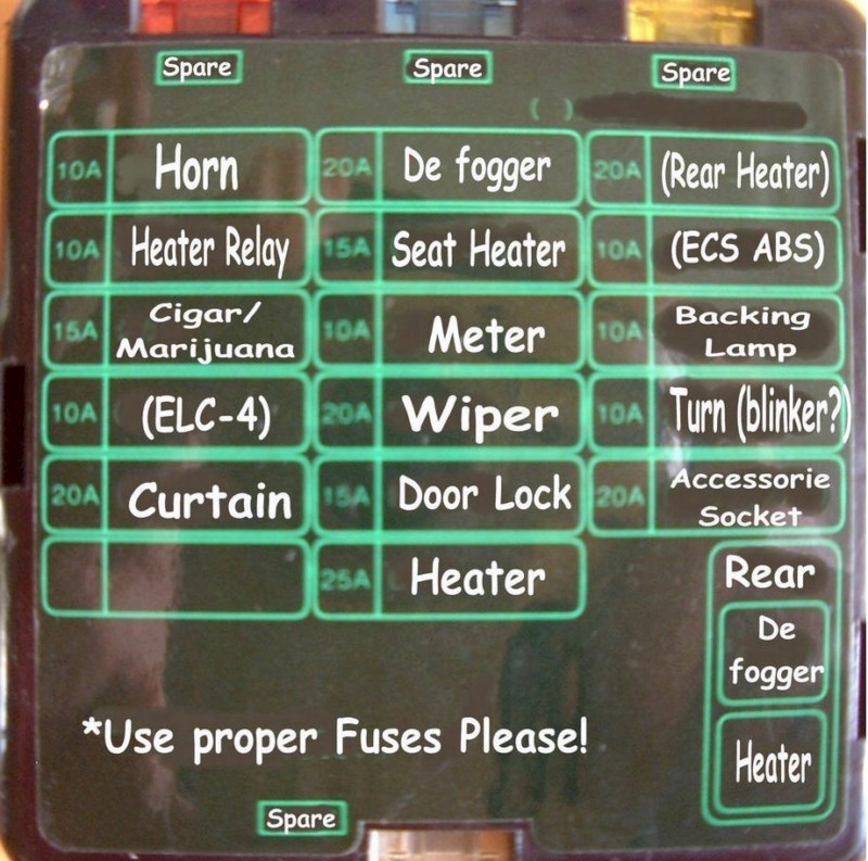

I found a post on the mdocuk forum
Pictures of the fuse box layout applicable to my Series 2
Probably the same as the Series 1?
http://www.mdocuk.co.uk/forums/viewtopic.php?t=1901
pictures for both fuse layouts
If this is a repost I apologize.
FS
DelicaFuse2 [1024x768].jpg (146.6 KiB) Viewed 2973 times
DelicaFuse1 [1024x768].jpg (80.97 KiB) Viewed 2973 times

What would the 20 Amp 'Curtain' fuse be for?
CREGAN
Posts: 1094
Location: Leduc, Alberta
Re: Fuse Box Layout L400
Post by CREGAN »
The electric curtains that come as an option in the Royal Exceed trim level.
izack98
Posts: 138
Location: Delta B.C.
Post by izack98 »
Ahhh, ok. Thanks!
