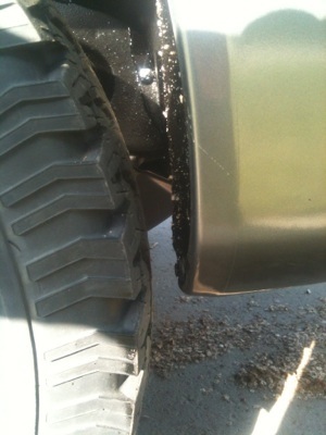

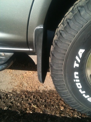

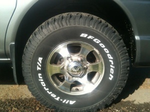

Thanks for the input guys. As per my usual style I researched the problem after the fact. Truth be told I had little choice as those BF Goodrich tires were on my 91Toyota Pick up that I have to sell:-( I didn't want to sell those tires with the truck because they are new. So I asked my mechanic to call with his opinion after mounting 1 front tire. He called me and said it will rub on the Mud Flap when turning hard left only. So I said go ahead with it. I plan on doing a 2" lift this fall, in the meantime I read somewhere on this site about tweaking the torsion bars temporarily until I can put a lift kit in.
So bottom line, those tires fit, but they definitely rub on the Mud Flaps when making tight turns in say a parking lot in either direction.
My concern is when the snow flies or if off roading I will see the problem really manifest itself.
Do you guys think that I will be fine with a 2" lift or should I cut my losses and abandon my plans for thos tires?

What do you think based on these photos?
- image.jpg (36.34 KiB) Viewed 6446 times
- image.jpg (46.63 KiB) Viewed 6446 times
- This is what I'm working with
- image.jpg (27.97 KiB) Viewed 6446 times

that's pretty close.
do the lift. you won't regret it. it's pretty fun.
jesse has a bunch available.
