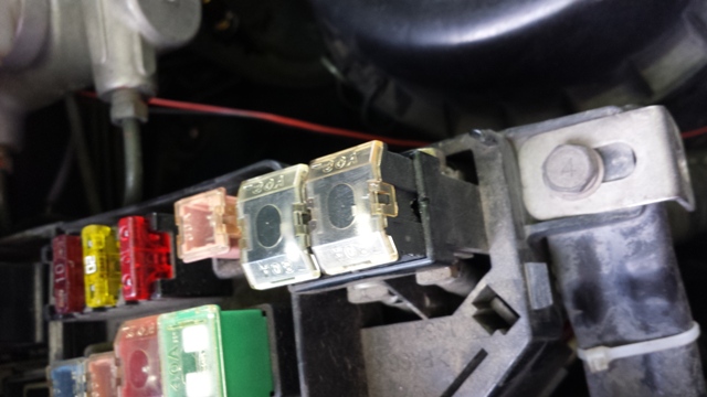

Dumb question, but I suspect that one of my 80A fusable links is toast.
I've tried to pull it straight out, but it lifts out part way.
What am I missing?
Thank you.
Big black fuses
Big black fuses
fuse link.jpg (94.07 KiB) Viewed 3192 times

You have to unscrew them at the bottom first, the bolts on either side that hold the wires also anchors the fuse.

Ah!
Thank you very much!
