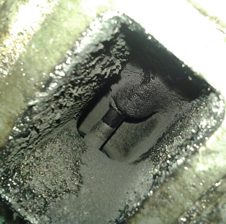

Re: where do i stop
just took some pictures
- this is the worst but they are all bad
- 2012-10-01 19.04.39-1.jpg (85.62 KiB) Viewed 4500 times
- LeeHammy
- Posts: 278
Re: where do i stop
Look familiar? Its a diesel.. They tend to look that way, sounds like you are like me. Unsure of something replace it! But there is a point you must realise its not a space ship... Its a diesel. Removing the PCV dump into your intake and EGR will stop that from happening, they are engineered to run with those so even dirtier then it is. It will work its way out eventually and be fine.

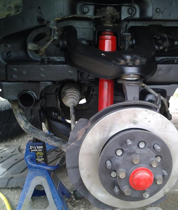

Re: where do i stop
i noticed some rust bubbles just infront of the lh front suspension mount so i picked at it and realised the frame rail had some rot. yikes..... so pulled out the plasma and boxed that section of the frame. then took a small side grinder and cleaned up the wheel well. repacked the axles with new boots. new disks new bushings now just have to paint the new calipers and put the wheels on then to tend to some rust on the rear frame by the rh wheel. its crazy because there is no rust on the van it just seams these two spots had spots missed in the seam sealer where the water could get in side the frame.
- 2012-10-03 12.13.49-1.jpg (59.17 KiB) Viewed 4404 times

Re: where do i stop
i work at an autobody shop i dont want to know what that cost you. i was luck my pinch welds had no rust and there was lots to weld to thank god it was just in front of the cross member.
