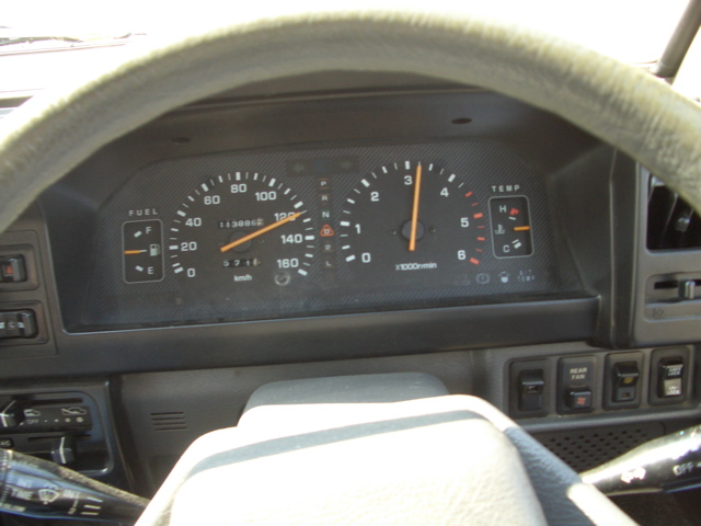

Re: Standard or auto?
This is on alevel hwy with a bit of a tailwind ,auto 91
- speedo.jpg (130.19 KiB) Viewed 8429 times

speed and revs look right, but oh my is your temp gauge high! you might want to look in to that...This is on alevel hwy with a bit of a tailwind ,auto 91
I was just thinking the same thing re temp.... Have you flushed the coolant lately?Green1 wrote:speed and revs look right, but oh my is your temp gauge high! you might want to look in to that...This is on alevel hwy with a bit of a tailwind ,auto 91

That pic is after two or three hours of pedal to the metal crossing Manitoba/Saskatchewanspeed and revs look right, but oh my is your temp gauge high! you might want to look in to that...
If I let off the pedal the gauge drops down in 1 or 2 km's, I have flushed rad and a new water pump installed. I don't see a problem.
Rik

yeah iv only ever had my temp gauge get that high climbing the duffy lake road up from lilloet lake(big ass hill)
