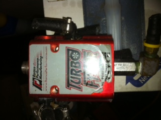

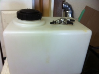

I have been thinking of converting over, currently I am now just doing the one tank thing.  I filter and centrifuge my own oil but production/pickup has been slowed as I may be moving shortly.
I do have some parts that I was thinking of selling. Namely a plastic oil tank with a hotfox oil pickup and a heated filter base. I would be interested in seeing the upflow system Delicat as I could maybe incorporate a form of it in my system.
