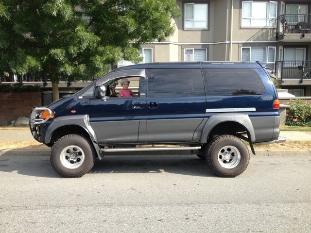

I wanted to try and minimize the "Japanese raked" looked from Blueberry. Currently, there is a 5" lift in rear, and 2.5" in the front. I figured that reindexing the t bars might even it out a bit.

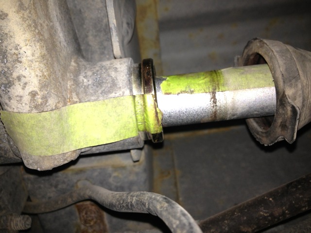

When I peeled back the boots, I discovered indications that reindexing might have already been done (see green tape in photo).
My questions are: would you concur with my belief that it's been done previously? And if so, can i I do it "more"?

Sorry for any lack of clarity- I'd like to give the front MORE lift (2 clicks of the tbar).
It looks like Something has already been adjusted judging by the tape. So I wonder if I can adjust it further.

Yes, the current lift is with 2" frame and ball joint spacers. I didnt expect to see any evidence of torsion bar lift, thats why the tape threw me for a loop

Then they were most likely moved to accommodate the lift. I think it would alright but you woulg need to get the front end realigned and make sure all your steering is able to work with that much lift. You might need different steering components.
