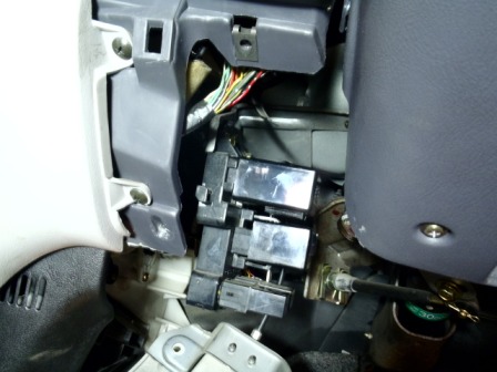

I removed the four screws holding the trim piece below the steering wheel and dropped it down. There is no need to remove the fuel filler door latch. The module is the top rectangular box in the centre of this picture.
It's a bit tricky to pull out as there are tiny plastic tabs that you can't disengage. A gentle prying with a flat bladed screwdriver between the module and the base worked for me.

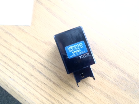

Here is the module removed.

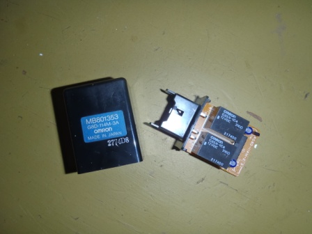

You can get the cover off with your fingernail revealing the circuit board and two relays and a chip.
There was a tiny burn mark on one of the traces on the circuit board. A friend soldered a tiny wire on for me and it works again.
I think the reason it burned out was because I did not disconnect the original lock motor after wiring in the new actuator. With both operating in parallel it was too much for the module. I have since cut the wires to the original motor.
