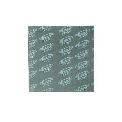

Given that my blanking plates are 6mm, I probably don't need a gasket. I was considering the copper gasket stuff I have seen around. But then I saw this:
Mr. Gasket 5960 Ultra Seal Exhaust Gasket
I picked up a sheet of this stuff from Amazon. It is about 1 foot square, so I have far more than I will ever need. But this stuff is THICK! It is about 2mm, and I will probably have to cut it with a dremel to size, as this is not paper, but feels more like some sort of carbon-fibre gasket. I am not even sure if I can use my tin snips to cut it!
Here is the description of the material:
Mr. Gasket Ultra Seal Premium Exhaust Gasket has the ability to conform to warped flanges for a tight seal. They have superior tensile strength to resist cracking. The graphite facing withstands heat and allows easy removal. The height of this gasket is 1.360" and its width 1.300". It incorporates a graphite-impregnated facing and a steel expanded metal core that reinforce and increase the tensile strength. It is designed and constructed to improve the sealing of exhaust header flanges. This gives the gaskets the ability to conform to warped flanges giving them better sealing capabilities without deteriorating or cracking under the excessive heat and pressure that is common in the exhaust system.
