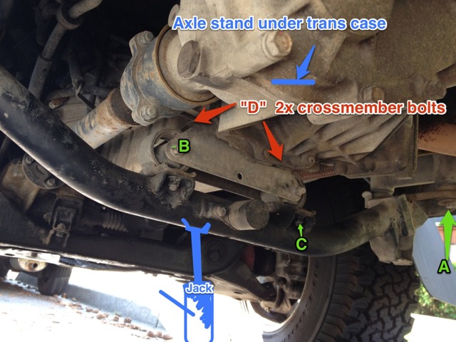

I planned on changing the gearbox filter this morning. However, I was stumped by the rear bolts on the sump.
They are very inconveniently located right above the transmission crossmember. It seems like the only way to access them is to remove parts of the crossmember.
Having never done this before, I am a bit weary of the transmission falling out and landing on my face. If anyone has removed the transmission sump on an L400, I could sure use some tips/reassurance.

unless you have fingers the size of a baby's and the strength of an adult's, you'll need to put a jackstand until the trans and a floor/bottle jack under the transfer case crossmember. Lower the crossmember just enough to get the rear sump bolts out.

Thanks Jesse - something like this (see picture)
I would need to release bolts "A" and "D" to drop the crossmember down.
So long as I have the stands in the right places, i assume the bolts should become quite obvious.
