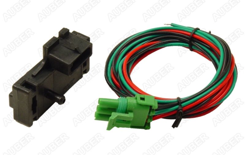

I ordered this from Auber instruments: http://www.auberins.com/index.php?main_ ... cts_id=122
It has a 1/4" barb on the MAP sensor.
I read on other websites I can use a short piece of vacuum hose to connect this to the Tee. Couldn't I just use a 1/4" male barbed connector on the Tee block? Or what's the purpose of using the ferrule connector over a barbed fitting w/ spring hose clamp?
Thanks!

Didn't realize you were using a digital reader. analog gauges use plastic tubing to transfer actual pressure to the gauge.
ferrules are used to secure tubing (plastic, metal)
barbed ends are for hoses.

Big-Bird wrote:Didn't realize you were using a digital reader. analog gauges use plastic tubing to transfer actual pressure to the gauge.
There is my confusion, I thought the hose and tube were the same thing, I didn't realize the tubing was rigid. doh! :?
