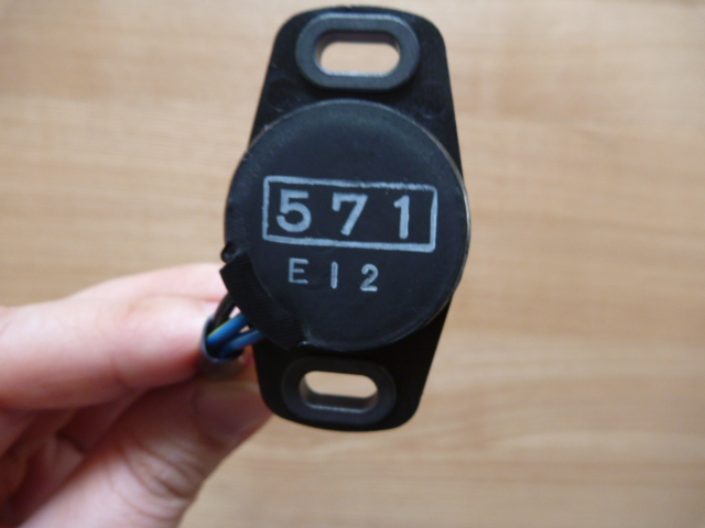

I'm struggling with my TPS tuning and smooth shifting. My van is shifting well all the way into 4th while accelerating and holds 4th gear when cruising at 80 Km/hr and above. Once I back off just enough to slowly decelerate to 70 or less, it downshifts into 3rd. I am not backing off to the 0 throttle position, just so I stop maintaining speed.
I've adjusted my TPS to .78 V and I'm playing with slight variations on either side of that setting with little success.
I have some questions if everyone can take some time to chime in.
1. Is the 3 digit number on the top of the TPS of any significance? Is it a part # or just a batch #?
2. If it is a part #, can everybody look at theirs and report what it is? I seem to have two of them with different #'s.
Mine say 423 and 571.
Thanks all.
Thanks all.

Mine says 423 along with the others I've seen. Part#

My old one says 423, new one is 571 (sent as replacement by Mardy)

Our new stock says 571,but our used IP says 423 T13.
I guess it is a batch number.
According to zexel diagram, it shows 310 as it seems a serial number.
Steven
Steven
