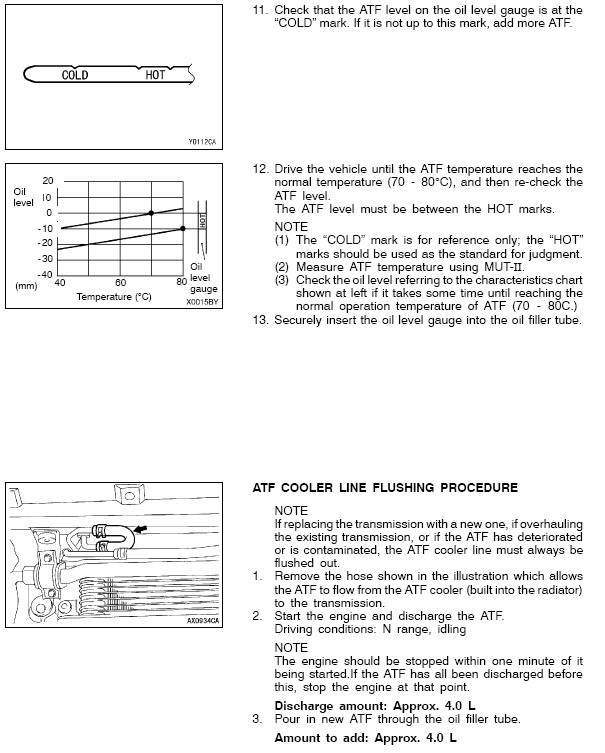

2) I recently had the ATF changed out and I want to check to see that the level is good. I heard that you have to have the engine running on level ground to check. Is that true? Also the dipstick has 4 little triangular notches on it and near the top one it says "HOT". Which notch should it be at or between?

Warm engine, shift through all the gears and then park it on a flat level to check the oil level.

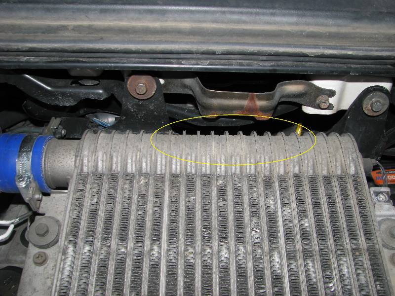

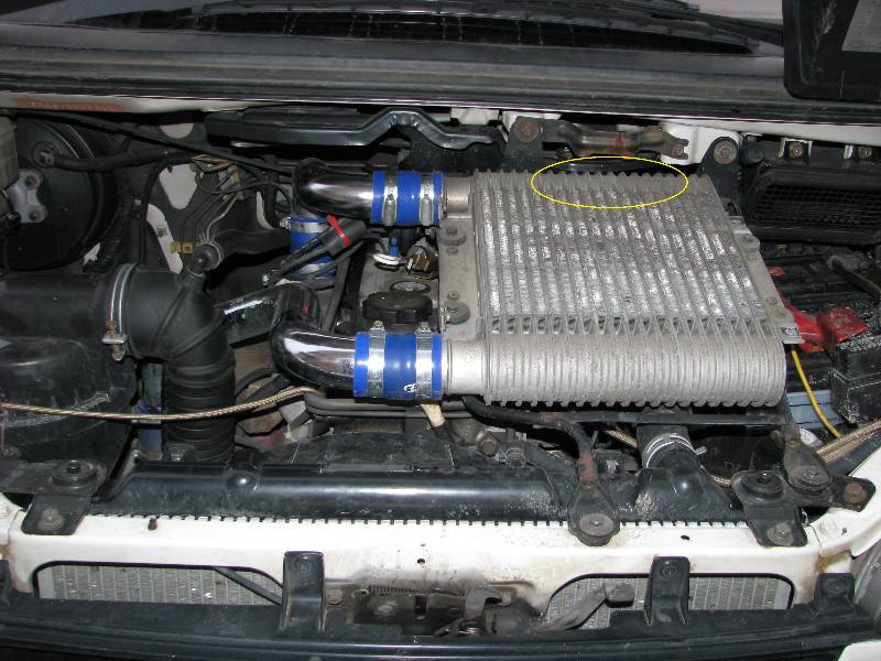

Alright, I have been out of the country for a couple weeks but am back now to sort this exhaust leak out. I did some serious sniffing all around the engine bay today and have tracked the smell to be at it's strongest concentration at the top middle of the intercooler, which is right by the cabin air intake. I know this may have nothing to do with finding the leak as I do not know how to stop the fan from blowing, so it could just be blowing the fumes there. Definately a leak somewhere inside the engine bay. Any ideas now, if this helps? I am a one man show here trying to get this sorted so I have not been able to plug the exhaust and watch for the leak- might try to get the wife to help me out (probably not going to happen). The smell is definately strongest when it is just sitting and idling. It smells so strong it is as if you have the exhaust directly piped in to blow in your face. When I am driving at any speed it does not blow into the cabin as bad. I really don't know what to do, and now my wife has decided she doesn't want to ride in it anymore as the smell is so strong. I have to sort this out. If I take it to a muffler/exhaust shop do you think they would know what to do (tracking it down) and where to look without trying to rape me? I am thinking that if I can just locate the leak I can try to fix it myself.
