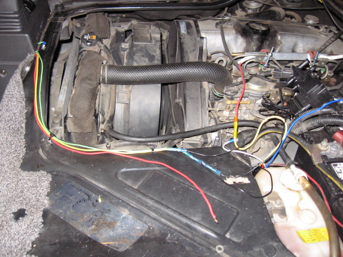

Wiring from Toggle attaches to Valve, 3 way connector and waiting to buy Fuse to hook red to battery.

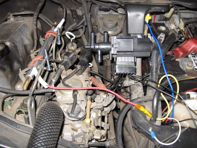

Vegetherm, Pollack Valve in Engine compartment

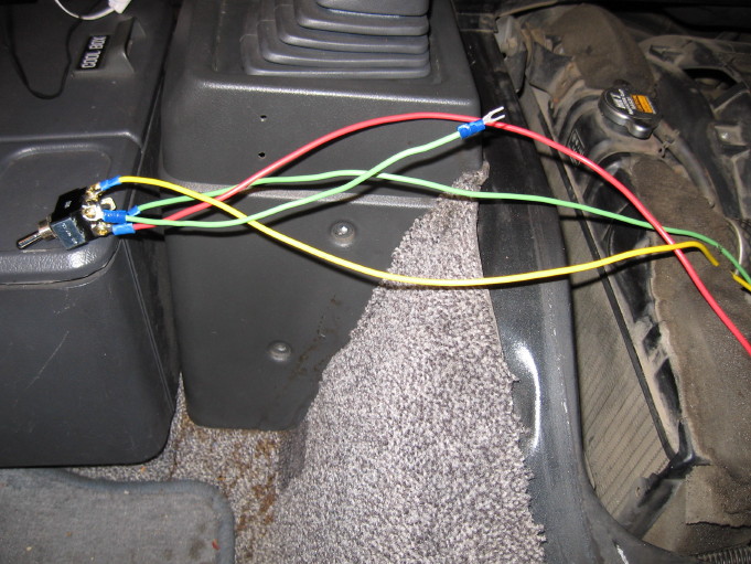

Toggle switch wired up

So I am all wired up on this fine Friday night. Connected my two red wires to the battery form Toggle switch and vegetherm. Let there be juice :-D :-D !
BUT
Adam wrote:
It all looks good now, although I'm able to switch the value and turn on the VegTherm without the key in the ignition, so I think I need to work on the wiring a bit more, don't want the kids being able to flip the WVO switch while the car is off and have things start to heat up.
Same problem Adam. Did you manage to fix that issue? I think I might wire the power for the vegetherm through the ignition switch. I figure if I don't get it done right away it is not a huge deal.

OK I cant sleep so I am looking at your pics and found a schematic online for the pollack.
I AM GUESSING AT COLOR BASED ON LOOKING AT YOUR PICS. I AM ALSO GUESSING THAT THE SWITCH WILL SWITCH GROUND AND POWER AT THE SAME TIME SO THAT 1 WAY YOUR YELLOW IS POWER AND GREEN IS GROUND, AND THE OTHER WAY YOUR YELLOW IS GROUND AND GREEN IS POWER. CONFIRM WITH A VOLTMETER OR JUST TRY THIS AND SEE WHAT HAPPENS.
I AM ALSO GUESSING THAT THE THERMAL SWITCH IS NORMALLY OFF AND TURNS ON A CIRCUIT WHEN IT WARMS TO A CERTAIN TEMP.
Looking at the pics, your green wire is + when you are on veggie. THAT IS MY GUESS
The only other option is you have actually wired it up as I have stated below but used battery power for the relay trigger instead of switched power but since you stated you only connected 2 wires to the battery, I am going to assume those 2 wires are the toggle switch and the vegtherm power.
Ok, assuming that green wire from your toggle is + when you are on veggie, so the yellow one will be -. You will have a relay controlling vegtherm, 1 circuit (I might have the numbers wrong though but I am 99% sure these are the numbers on the relay) will be 85 and 86 (trigger circuit), the other will be 30 and 87/87a (load circuit), 87 being the normally open circuit. You should already have vegtherm circuit connected to the 30-87 circuit.
Now, I am betting you have the relay trigger grounded all the time and the power for the trigger comes from your switch. Change this. Power the relay trigger from your ignition switch and connect the other side of the relay to the diesel wire (yellow) this will be the ground.
******Quickest way to do it***********
*****Since you havent plumbed your hoses yet, you really only need to take the relay trigger wire off of ground and move it to a switch +. The relay doesnt care which trigger is + and which is -. Then switch to diesel on the toggle, figure out which supply and return circuit is open, connect that to diesel, then switch to veggie, confirm it is correct, plug the last hoses in. JUST MAKE SURE THAT YOU CHANGE MY INSTRUCTIONS ABOVE AND BELOW TO MATCH SINCE ALL THE COLOURS WILL BE THE OPPOSITE. IF YOU DONT UNDERSTAND ELECTRICAL ENOUGH, ERASE THIS WHOLE PARAGRAPH AND FOLLOW EVERYTHING EXACTLY AS IT IS WRITTEN.***********
Now that thermal switch is a bit tricky. Easiest way to do it is to cut the yellow wire in between the toggle switch and the point you taped into for the vegtherm relay ground. This will make it so vegtherm isn't getting a ground and heating up diesel (assuming both run through vegtherm) or heating stagnant veggie. So you can just start the car flip the switch and start driving.
If you have diesel and veggie flowing through vegtherm and want the electric heater to start up and heat diesel too, you can put the thermal switch on the green wire. I dont know if that is a good idea since I am not sure about heating the diesel that much. I cant see it being an issue. I know preheating diesel with a glowplug style heater is a bad idea but vegtherm should be ok.
THE DOWNFALL WITH THIS SYSTEM is that if you forget to change over to diesel for whatever reason on shutdown and somehow ignore the buzzer (or you dont have a buzzer), it will not be able to switch over the pollack valve until the engine warms up enough to turn that switch back on. I dont really see that being possible since the only way to turn off that buzzer is to flip over to diesel so you should be good to go, doesnt matter if you shut the car off first or not, just shut that buzzer up. If this does happen for some reason, you can just unplug the thermal switch and join the 2 wires together for a second while the toggle switch is on diesel, then connect the switch back up and go.
