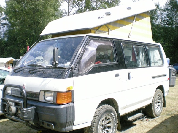

I'm in the process of designing some hinges for a front hinged/rear lift home made poptop roof for the pig (L300, low roof, swb)
It will be similar to the below:-
http://www.delica.ca/forum/download/file.php?id=11301
http://www.delica.ca/forum/download/file.php?id=9429
http://farm4.static.flickr.com/3649/369 ... 5a2a_o.jpg
http://111kuroyanagi1.files.wordpress.c ... n-160k.jpg
I've made a few prototypes out of stiff card to test the angles etc, but can't find a good clear picture of the real thing.
What I'm after is dimensions/design of the hinges so when I get them fabricated I'll know they'll be strong and durable enough.
Anyone got a pop-top or know an owner I can contact to ask for some pictures/measurements?

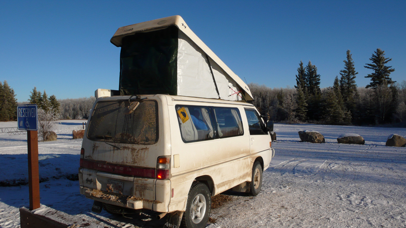

Go with Westi hinges...I got the whole roof off a Westi for $200 I cut the steel roof and all parts above the side windows and drove away with it.... find a breaker and get the hinges.
LOST2 has done this is and is driving to Mexico with his family at the moment:
http://www.delica.ca/forum/pop-top-defi ... 11110.html
I started poptop and went hitop fibreglass roof. If I did it again I would do the HITOP. Easy to seal, extra storage (bedding, cloths, etc..) stand up all the time give up about 1.5 feet of clearance. Never have to dry the tent, warm in winter...LOVE IT. Oh and I forgot easy:
2 hours take high-top off, approximately 30hours cut, fit, install, and finish inside.

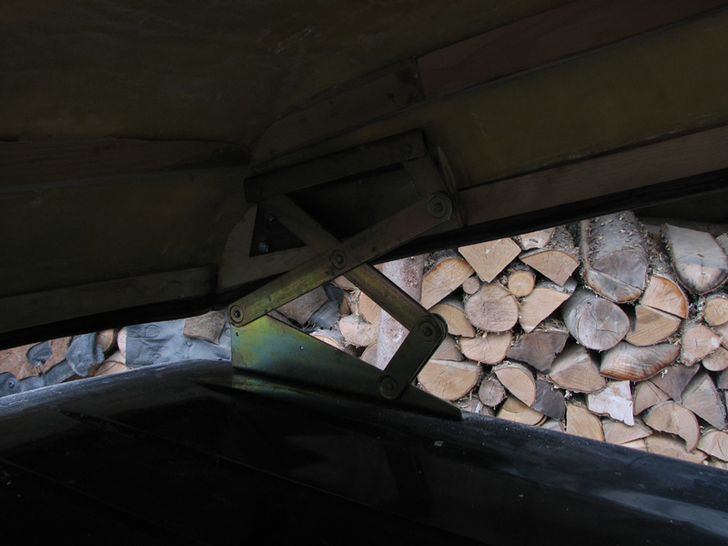

Here's my estimate at the moment, based on various pictures I've found and a cardboard mock-up I've made
Any comments welcome!
I'll be fabricating something like this hinge:- (picture from Lost2)
