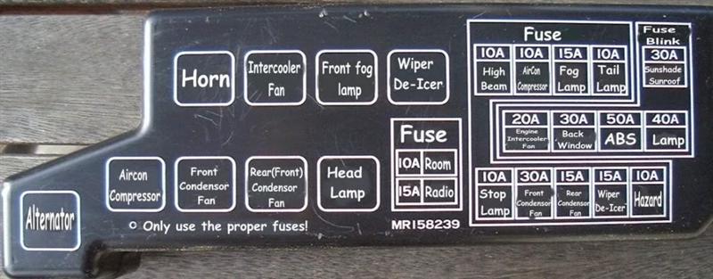

lost the cabin lights, radio and clock all at once today anyone have a diagram of the fuse box in the l400

Is this the right one?
L400 fuse box (Medium).jpg (53.42 KiB) Viewed 2833 times
Right On? 8-)
Re: l400 fuse box
that's it bro :M

thanks for that
