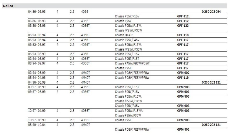

I posted the Bosch Glow Plug Specs Catalogue recently and it shows all dimensions and power requirements of the different plugs used in these two engines and I agree most Dealers seem to be OVER simplifying and putting the wrong plugs in these motors.
How many post do we need to see "changed my glow plugs now my ECU doesn't work" = wrong plugs 99% of the time.

I will post this in this thread again...gives Bosch numbers but more importantly the specs for different systems
See the back of this catalogue for all the specs on glow plugs:
Bosch Makes glow plugs for the Delica (L300&L400) from the Bosch.au website:
See page 28 of 88:
http://www.bosch.com.au/content/languag ... _Ready.pdf
See page 28 of 88:
