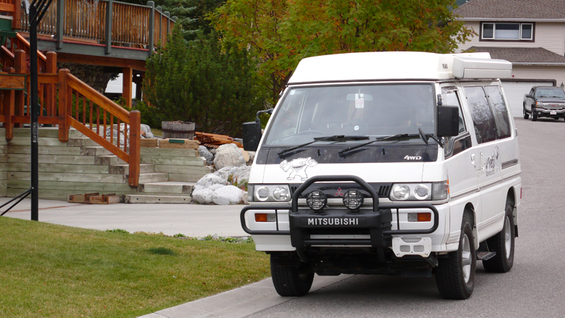

As most of you know, we own a camperized_from_the_shop Delica L300 Exceed. So far, we only did a few changes that we were comfortable doing ourselves.
At the last Calgary mini-meet, I met Erebus and we were talking about our little babies and looking at his and listening to everything he did himself... I felt that I had no credit for having such a little van the way it was. I started to realize that there is a lot that I can do to improve it and make it better for the long run.
That said, we decided to start doing the things that we were talking about. So on this thread, we will post the upgrades, mods and anything that we will do, ourselves, that might be of interests to all (or most) of you.

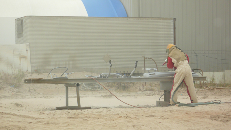

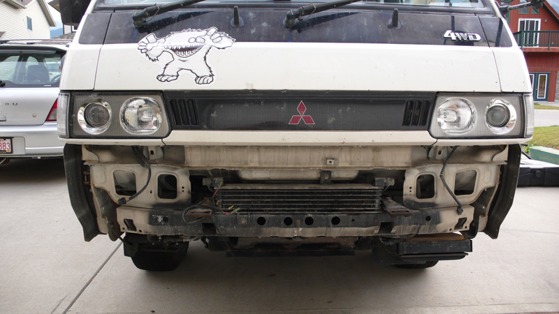

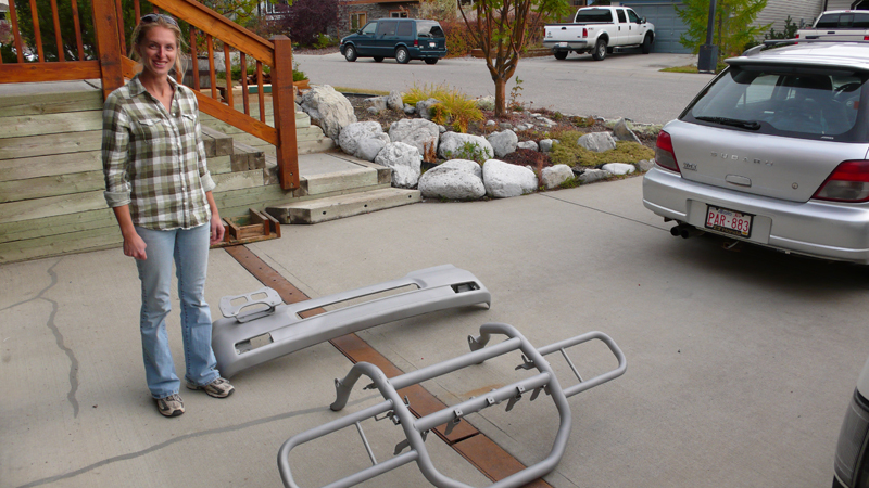

So... here we are. After our 16000km trip last winter, the front end took a bashing from the rocks coming from the cars that would have been way too close to us (actually I have the tendency to drive way too close behind... yeah I am one of those).

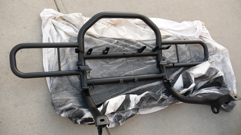

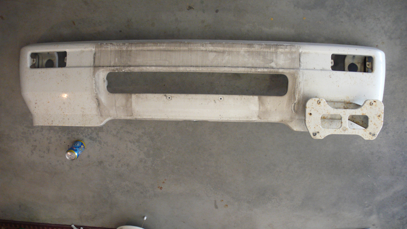

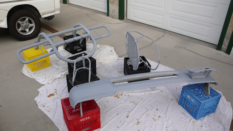

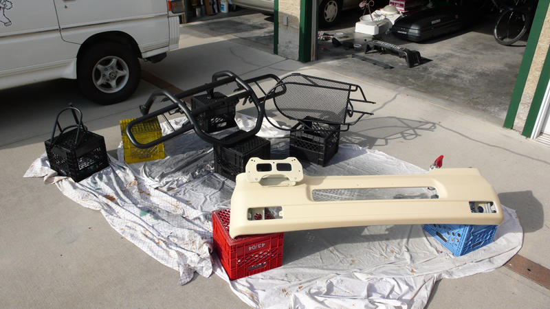

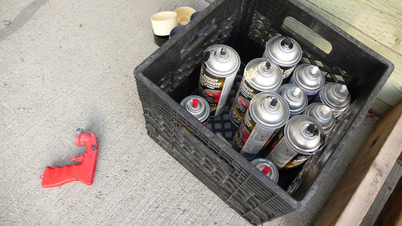

So we took the bull bar, plastic cover and main front panel off, sand blasted (professionally... see the photos), anti-rust coat, primer and 2 coats of rockguard. Great product to work with by the way. It look really good, but closely, very closely, you can see some imperfection and the white is different then the delica white... too white in fact. So it does bother me, but I will leave it like that until I see in a few years, that the panel would need a little touch up, then and only then I will repaint it all with a closer to original white.
Have a look at the photos and please don't hesitate to ask questions, comments and even make fun of me go for it I can take it, just remember that I will get back at you 8-)

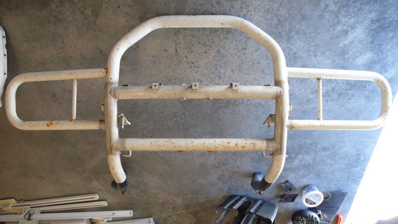

A lot of rust on this one...

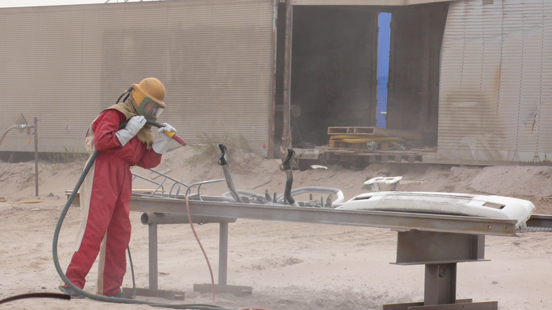

A real professional sandblaster... :)
hummm... That is actually me... we went to Consolidated Compressor, you rent a spot, they provide everything for a max of 125$ an hour... it took me 50m... so 90$ to do the job

More photos!
Turn out to be bare metal, no rust spot.  Actually I really liked the color...

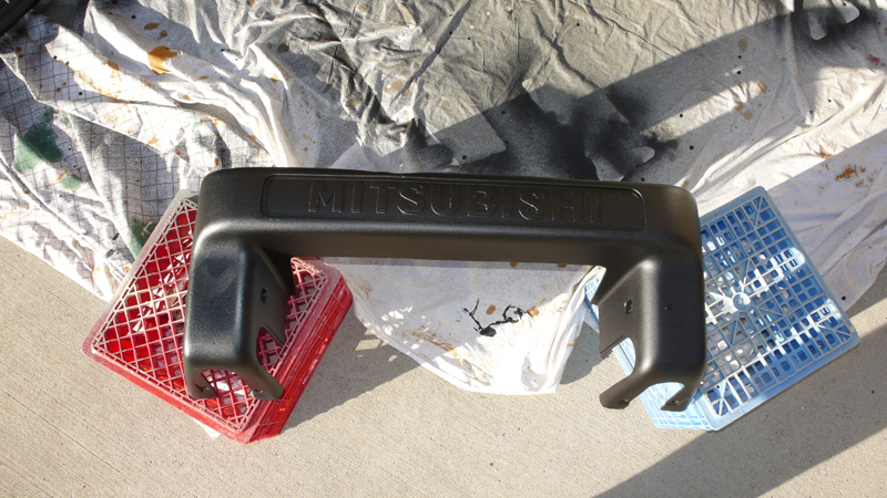

Rockguard on plastic turn out amazing! I really like it!

One more upload...
And up close... not bad at all... says me ;)

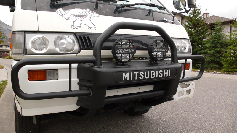

And there is the final result!
With 100$ worth of paint can... not spo expensive...

Re: Mighty Yeti Upgrades
Nice! Looks really sharp :-)
Fred, nice job on the Mighty Yeti, indeed! The Bambis look stunning in black, better than the white.
So,... when are you going to paint the rest of her?

Falco, we have no intention what so ever to paint the rest of her... unless it become really spotty and rusty. By the way, you remember telling me to look at the 2 spots on the bottom part of the back window... that will be the next step... I might even rockguard it all. There are a few rust spot on other places on the back door, which it's weird, but I will have to deal with it. So I am thinking of removing the whole, door, strip it of everything, sandblast it to get ride of the rust and rockguard it... next year though...

Looks great - like a new(er) van! Nice to see another rattle-canner amoungst us.

I hate advertising stuff on my threads, but psilosin is right… I was looking for a company to sandblast my parts and everybody were charging a min of 200$… found that place; http://www.consolidatedcompressor.com/ and it was 90$ tax included! What really got me was that when I showed up, the lady at the counter asked me if I have done this before. I said no, so she asked one of the employe to show me how to do it. No paperwork to sign or waiver prior playing with the sand. What concerned most the employe was to keep my car at least 30m away so I would not blow my windows. I was thinking… well if I drop the hose and it goes every where… will I lose my head? I gues that was not much of a concern for them hehehe… Anyway it was cool to do it myself!

Dude! That's awesome, it looks great.
I have a few questions:
1) The plastic "MITSUBISHI" cover/shroud - what did you paint it black with? Mine is grey and looking really old... I'm thinking of either removing it altogether or painting it black as well;
2) Did you consider not putting the shroud back on, and just leaving the bars?
Luis
