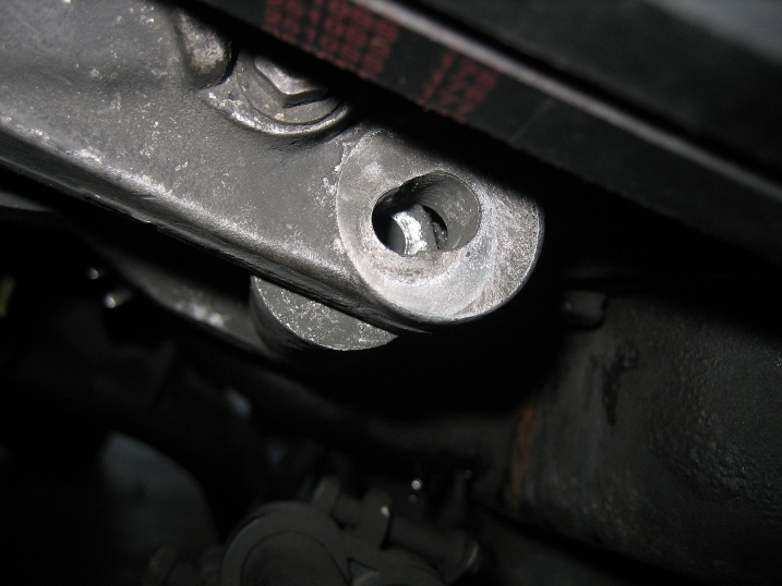

This is what I found under the van originally. Original bolt was gone, somebody fabbed up a spacer (3/8 socket!) and new bolt, which surprisingly (!) came loose.
delica deer 004 resize2.jpg (184.78 KiB) Viewed 12505 times

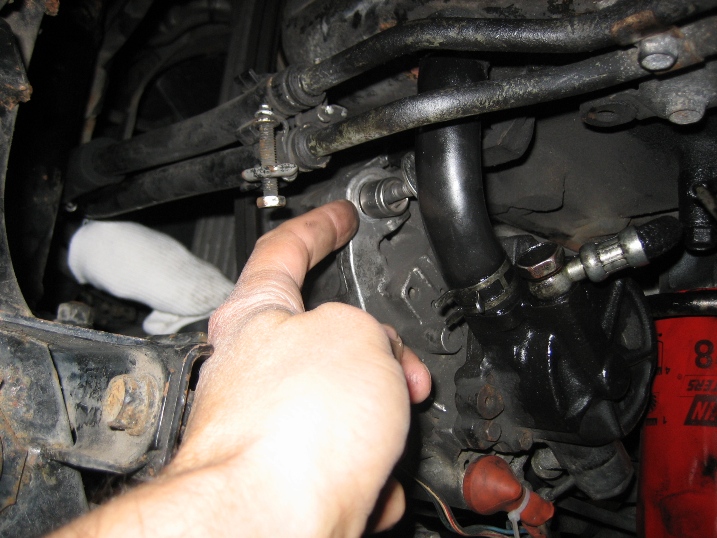

This is the result, from the front. offset ovalizing...
delica deer 006 resize2.jpg (131.58 KiB) Viewed 12505 times

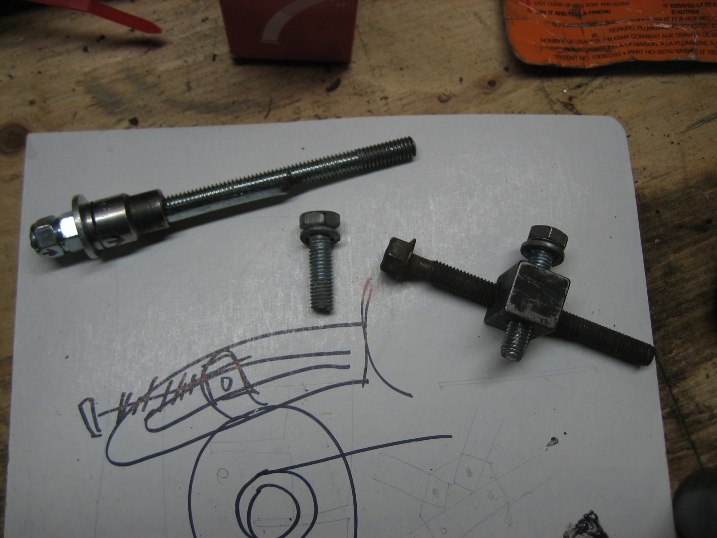

THis was my first attempt using the original spacer I found in there.
delica deer 011 resize2.jpg (156.45 KiB) Viewed 12505 times
