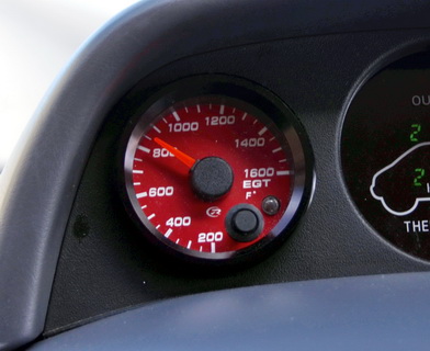

Nahds, your EGT readings are OK. The image below shows the EGT while climbing at 80 km/h. Although it does not give you the exact temperature in the exhaust manifold you know what is going on and helps you to control your right foot.
BTW the EGT will vary at the same driving conditions depending on the elevation. Driving in Yellowstone park recently (2200-2600 meters above the sea level) I was constantly getting 200F higher temperatures on the hills comparing to the same style of driving along the Oregon coast.
- DSC_0860_resize.jpg (83.25 KiB) Viewed 3123 times
