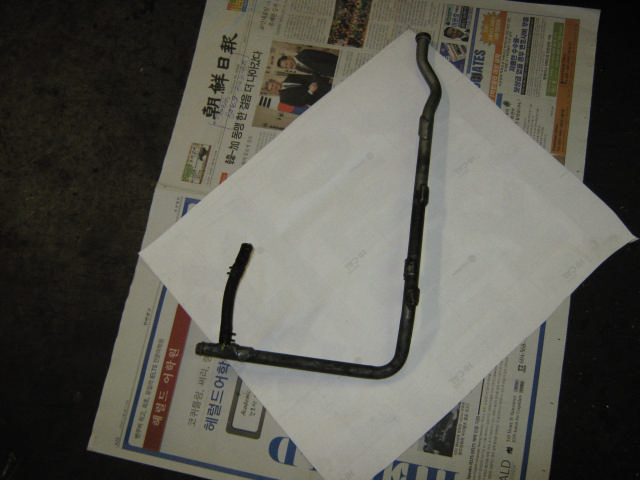

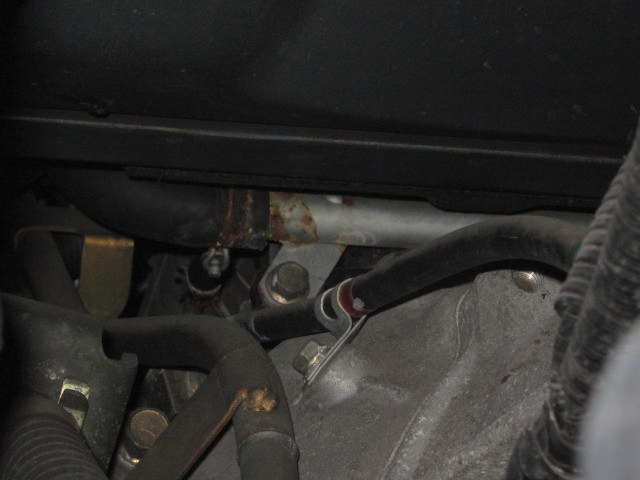

Also check the coolant tube going from the thermostat housing to the turbo. It may be blocked (unrelated but good to check)

Good point, jfarsang.jfarsang wrote:Also check the coolant tube going from the thermostat housing to the turbo. It may be blocked (unrelated but good to check)
Not often, but possible problem for L400.
Also not a good spot to fix.
It will be worth to use a good quality coolant expansion bottle for your replacement.
Steven
