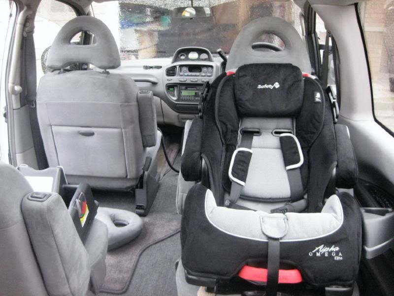

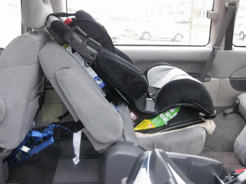

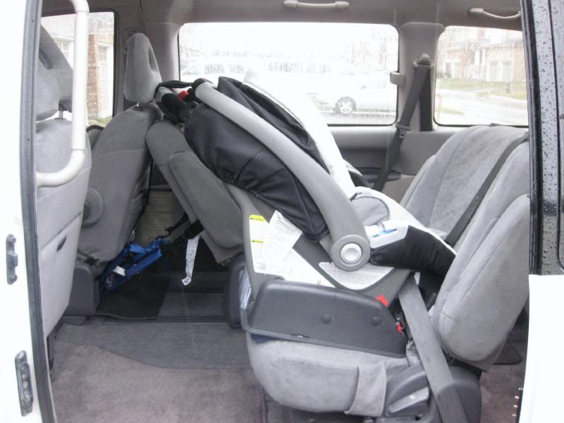

just wanted to share (and get some input/advice/comments) on my planned seating arrangements for our 2 1/2 year old and 2 month old. i read lots of threads on this with searches so i based my decisions on what's been done, just thought i'd show how i did mine on the l400 (as most threads were on l300s) and see if anyone can add anything. we bought the l400 for longer trips with the inlaws in mind (if it was just us 4 then the cruiser would do fine) and we needed a 2nd rig. the plan is to put the kids in the middle for ease of loading them in, our 2.5 year old will sit behind the driver while baby next to him on the sliding door side for ease of taking her in/out. to maximize room inside, i went with rear facing for my son for more leg room and so the inlaws can keep him company. i'm goin with rear facing is safer too (but thats been debated i think). i took the head rest off and slid it forward right against the drivers seat for max leg room in the back. i used the captain's chair lap belt and i used the belts that came with the car seat and anchored in to a strap attached (or slung around) to a round metal rod at the base of the drivers seat. the rear teather is also attached here separately. it's on there good and snug and the seat is reclined to where it should be. too bad i couldn't have it upright a tad more thus allowing me to slide it that much closer to the front and giving more leg room in the back. anway, pics explain hopefully.

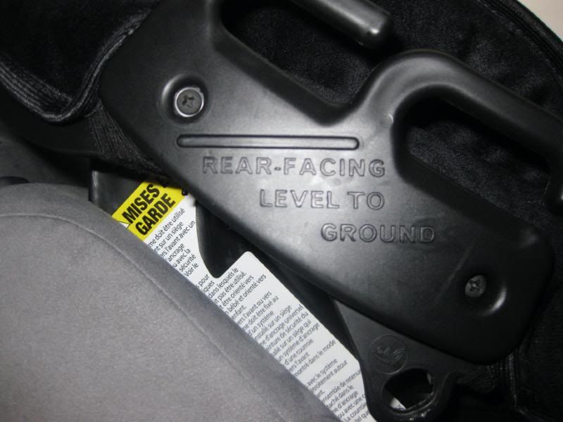

this has to be level to the ground...

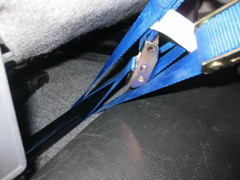

taking the head rest off (not needed) got it that much closer to the drivers seat (which can't go any further back for me, the wife will just move it up a couple notches) also some storage space in between the back to back seats...

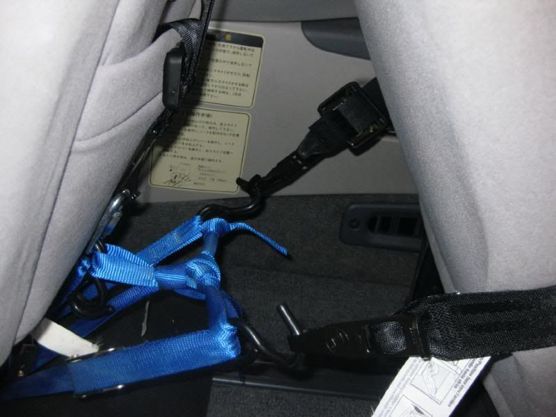

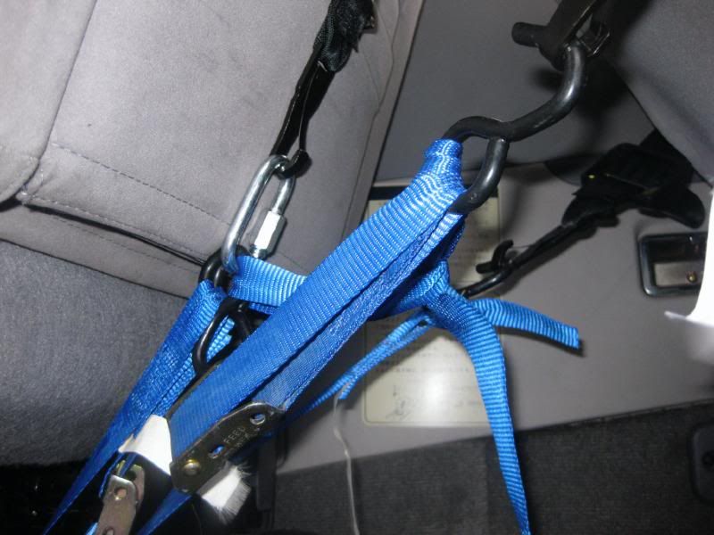

the two hooks/strap that came with the seat is snuggly attached to the strap (the extra strap i just wrapped around the area a few times just to tidy things up and keep it from loosening up, i check these periodically)
teather hook is in the centre attached to that chain link
here's that bar on the bottom under the drivers seat, it's pretty dang solid
kinda redundant, i think the black strap is much more secure than the captains chair lapbelt which i can't get tight anyway...
with the assumption that forward momentum/front end collisions are more common (than getting rear ended), the teather strap is not as crucial as if it were a forward facing seat (plus there's the drivers seat right up against it that can help stop/prevent further movement or act as more cushion....?)
let me know what you think....
i can easily turn him arround, move the seat as far forward as i can and still allow movement infront when strapping him in (and just using a clip for the shoulder belts to hold the seat down) but then i'd have to jimmy up a teather anchor on the floor, or something under the rear seat mounts? but taht would crowd up leg room for the inlaws...

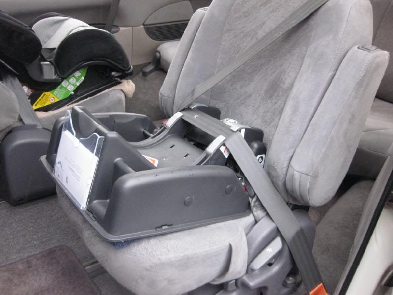

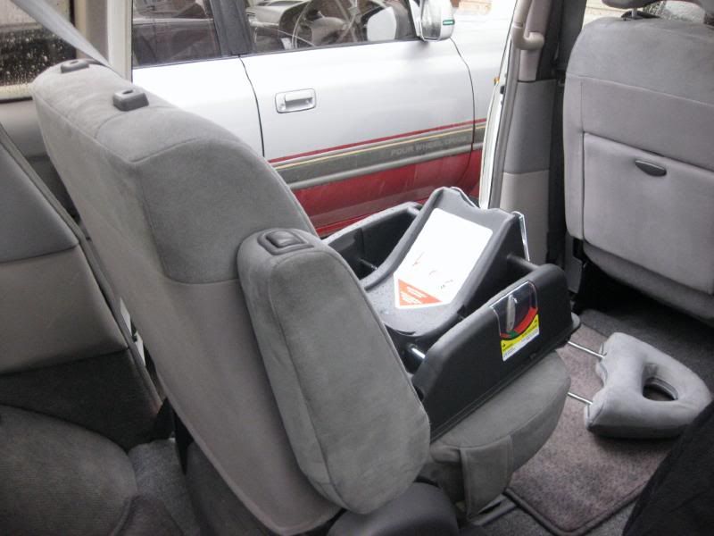

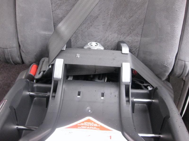

here's the set up for our 2 month old...
this captains seat is as far back as i can be... leaving ample leg room for whoever is behind

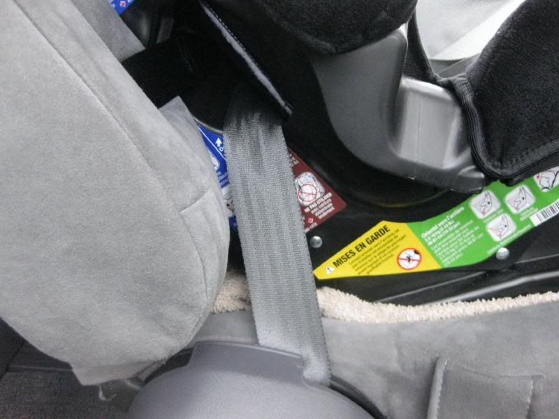

the main attachment is the shoulder belt, with a clip, it's on there good....and the redundant lap belt underneath...
took the head rest off too for more viewing pleasure for whoevers sitting behind.
and here's the slight issue with getting in/out of the van. a slight squeeze next to the baby seat installed, so really, the adults and 2 year old should hop in first, then snap in the baby...
really, this is the best place for our youngest, it's just too cumbersome and heavy to haul her in to the back (if it was my wife using this van more) or across to the other captains seat, that'll just wreck our backs, and then our son would eat up more room if he was next to the sliding door...
any comments on this? i thought about sliding it further forward but that eats up more space to try and get inside behind, plus it's harder to get the seat bolted on and off....

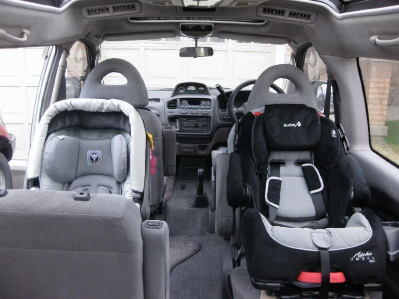

orrrrr, at least for our florida trip, should i use the middle of the back seat for the baby (and the rear lap belt can be tightened nicely too), keep my 2 year old as above, and then facing the passsenger side captains seat backwards for more leg room for everyone? hauling baby will just be a two step process, put inside in the floor, hop in, then carry up and into back seat and snap in. OR have baby passenger side rear bench and 2 year old drivers side rear bench, inlaws facing backwards in the captains chairs leaving room between kids for mom to hang out if she's not up front...? the rest of the time, we'll be driving with this van as a family and will definitely need the room in the back (as it sits, our city select 2 kid stroller does NOT fit in the back! doh!) our regular peg perego single stroller does so we'll be taking that instead to florida with inlaws...

here's mom's view when she sat in the back for the first time on our 1st family outting, she loved it! and she was able to keep junior occupied and her eye on little one. (bench next to her had to be folded up to allow room for bulky folded stroller...) she still also had lots of leg room.
hopefully, someone with kids in the same boat looking for a delica can find this usefull :)

On your middle captains chairs, fully extend the LAP BELT and then slowly let it retract, you will hear a clicking sound, this is the child seat belt lock. There is a tag stitched to the end of the belt that explains this, and refers to the owners manual.

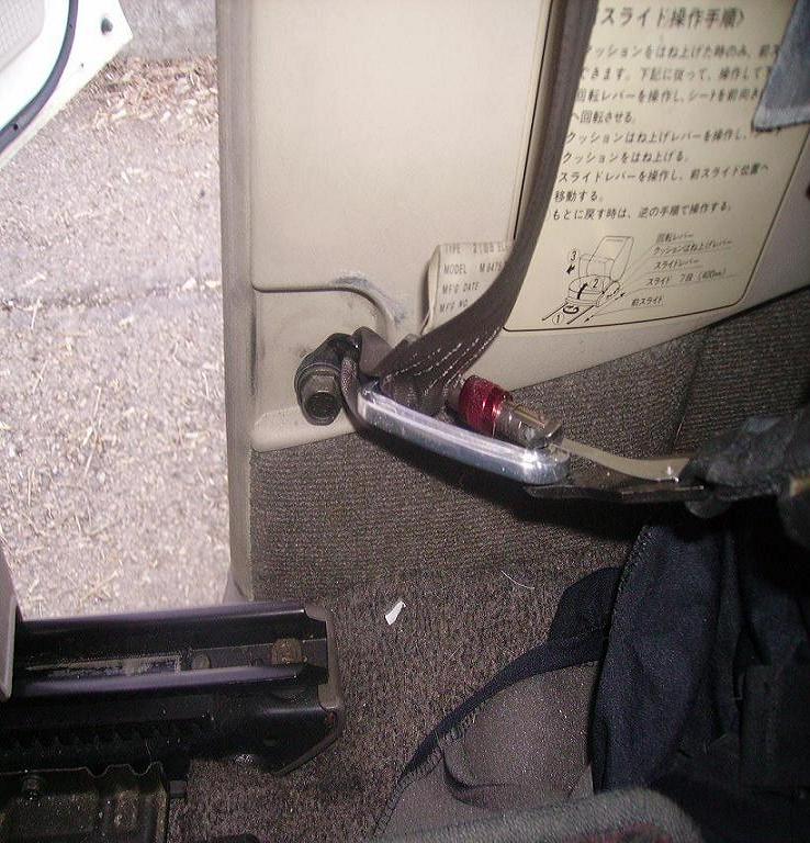

Here is a pic of my teather connected to the drivers seat belt anchor. If a guy wanted to go all out, you could remove the bolt for the seatbelt, and replace it with a longer one allowing for an additional anchor point. But I think this is fine, those seatbelts are tough, for the rear ones you can do the same thing to its own seat belt anchor.
