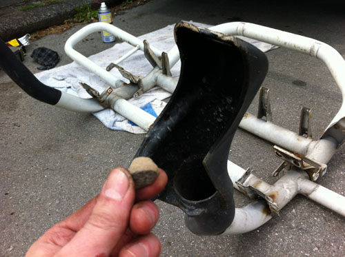

I think I found the source of my rattle. It sounded like it was under the dash, and seemed to coincide with going about 40-60km/h, so I thought it was something flapping in the wind. But I'm pretty sure this is it.
I took off my bull bars to sand blast and paint them, and there was something rattling around inside. I dumped out a rock about the size of a die (dice). I'm going to plug the end of the bull bar with some foam rubber so this doesn't happen again. Very annoying, and quite a hassle to remove to get the rock out.
You might actually be able to fish a stone out of the end of the bull bar with a coat hanger or something, without removing the bars. It would be right at the bottom near the opening.
I hope this helps somebody!
