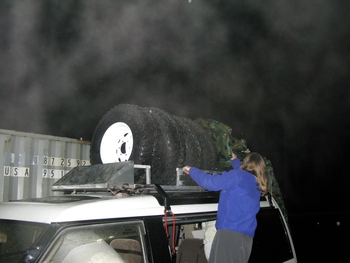

The tire project is almost finished. Thanks to TardisDeli we made a overnight trip down to the States to pick up the tires. The officer at the border did not even bother to charge anything for it :)

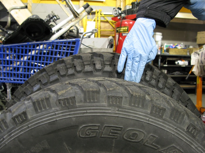

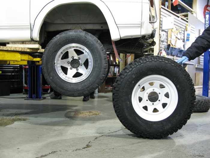

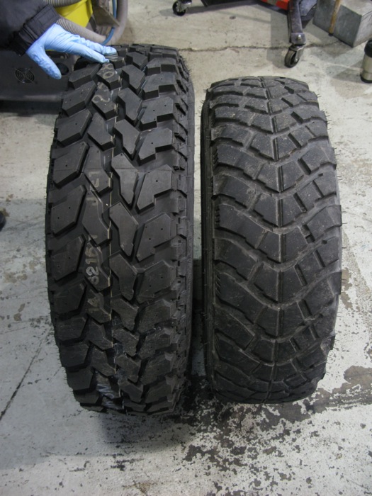

Everyone got almost a heart attack as they saw the tires :D They are huge! At least compare to the worn down 30x9.5R15 Geolander M/T. There need to be a little bit of trimming done on the front, but overall I'm surprised by the good fit. Will see how it is once we go offroading. So far I can not report about performance and handling. Still nor insurance on the vehicle, but I'll get back after a few trips.
