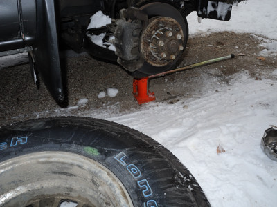

jfarsang wrote:a sledge hammer and 2x4 is the only safe solution. You wack the rubber, not the rim.
all the rest have the possibility to cause damage
Sledge hammer and 2x4 did the trick. I had to do All four tires.
thanks everyone :-D

I have bent a rim with a 2X4 only, it took a torch got it off for me (friends car steel hub centric rim seized on to the hub).
Happy to hear you got it off.
Put "nobind" (anti-seize) or paint to prevent it from happening again.
